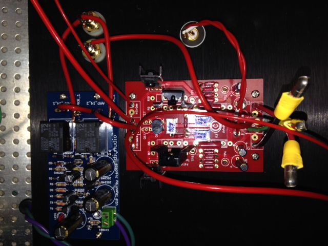

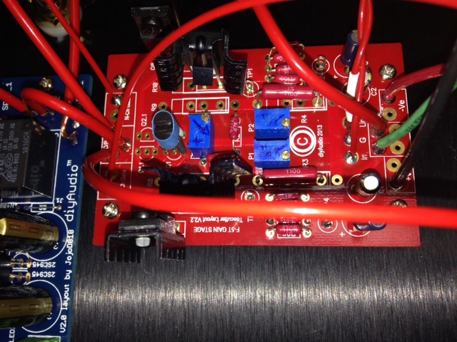

I just tested them again and got the following readings:
PS ground to drain pin on 2sk170 -- 1.43 VDC
PS ground to drain pin on 2sj74 -- 1.60 VDC
Scott
Disconnect the dim bulb. Anything that burns I will replace. Make sure nothing lies between the FE board and the PSU. Not sure if the Soft start circuit could be responsible. Disconnect the output boards. They are not needed to make sure the FE is working. After doing the above, remeasure.
Your measurements do not make sense. At first you had a diode drop(Vbe) on the drains of the Jfet of appx. .66V. Now you have about double that.

The PCB has room to be configured many ways - deal input Jfets, parallel feedback resistors, etc... As well as extra pads on many connections, to better for more wires or different shaped resistor packages. To my eye it looks stuffed properly, as far as I can tell through the photos.

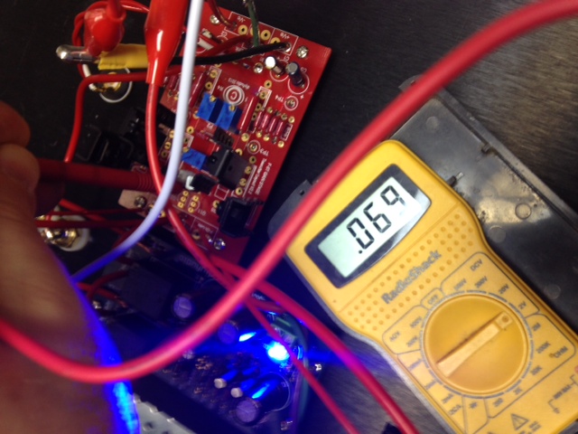

PS ground to the drain pin on the 2sk170bl (Q1) is 0.069 VDC
PS ground to the source pin on the 2sk170bl (Q1) is 14.0 VDC
PS ground to the drain pin on the 2sj74bl (Q2) is 0.066 VDC
PS ground to the source pin on the 2sj74bl (Q2) is 14.0 VDC
PS ground to TP1 is 47.1 VDC
PS ground to TP3 is 40.8 VDC (yes, I checked it several times).
The photo shows my reading when checking PS ground to the drain on the 2sk170bl. I also checked that twice.
I am confounded. Any thoughts?
