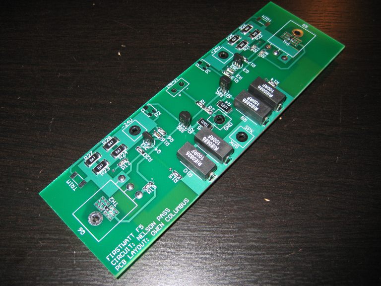

F5 PCB's
Hi Roumen,
The boards are here, I've built up and tested my set, and I only have two more single channels available to sell. All the other boards went pretty quickly. If there's enough interest I might have a proper run done which would further reduce the cost.
I'll set aside the last pair for you if you're interested. They're $15 each, and I have enough parts around here to put together a kit if you'd like.
Send me a PM and I'll email the PDF files and price list.

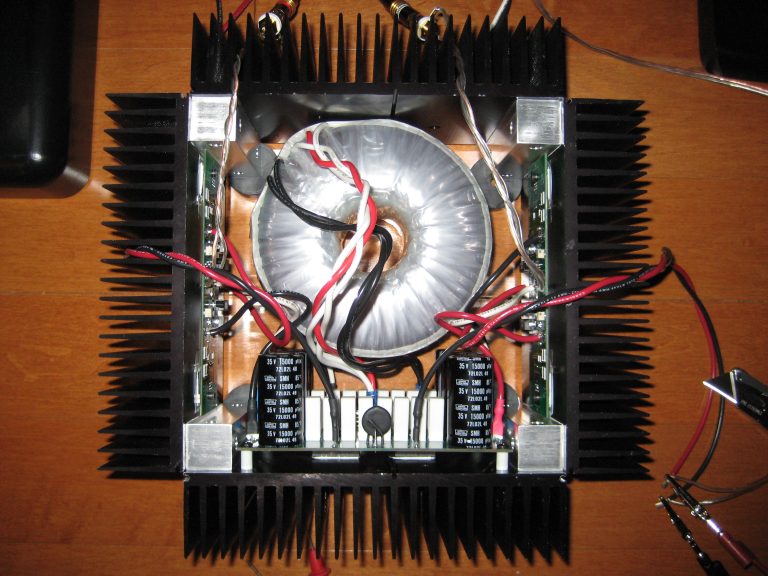

On that same note, I have attached a picture of my finished F5 (well almost finished, you know how it is)
I got the offset down to 0.01mV, rails are at 23.95 but they move around a little bit during the day depending on the wall voltage. Heatsinks are 51C directly behind the fet, and about 47C elsewhere with a 24C ambient. THD+N was 0.002 for the first channel, and 0.009 for the second, but it trimmed down to 0.003 with a lot of patience. All measured with an AP2 at 1 watt 1kHz and with a lab supply.
The AP wouldn't measure past 200kHz, but using a scope it looks flat out to about 600kHz, where it starts to drop off.
Now, I have two small issues that I'm a little curious about. The first is THD+N performance with the unregulated supply. When I substitute the lab supply with the unregulated one, the THD+N numbers jump up to 0.009 and 0.0101. The distortion vs. Freq also shows a bump at 60Hz and a notch at 120Hz, indicating that the added noise it definitely from 60Hz hum and the rectifiers.
Any suggestions on how to reduce this noise? All the above measurements were taken with the transformer well away from the chassis (not mounted in the middle like you see in the picture) so I don't think it's induced noise.
The second problem I was having was with square waves. I was looking at the square wave response at 200kHz, and I noticed that they didn't look that great (overshoot mostly). When I put the input up on the scope as well, I notice it was distorted too, and was overshooting in a similar manner to the output. I swapped the generator for a much better unit, and I got the exact same distortion on the input. When I disconnected the generator from the F5 the square wave went back to normal. This seemed to start happening at about 60kHz and got worse and worse the higher I went. If anyone knows what is causing this, please let me know.
Owen

Owen,
I think (even though I might be wrong) that you missed one maybe crucial detail, the input fets are placed far from each other and it would be wise to thermically couple them to each other. I couldn't get a figure on DC offset when I was setting up my F5 clone, that is, I constantly had (and still do get) 0.000 DC figure (@200mV range) and didn't measure it on any special or advanced equipment. No hum or noise. But, the input fets (170/74) are matched to identical characteristics and coupled together. The PS is somewhat beefier as well, 2x22mF+R22/25W-per rail+4x33mF per channel.
Input JFETs
Hi stein2
I debated the input jfet thing for a while (see my earlier post) and I settled on the current arrangement which favored layout over the close coupling of the jfets.
I messed around a little bit with this once they were built, and I found that if I physically grabbed one of the two jfets then I could make the output DC drift from less than 0.01mV to closer to 10mV, but under normal operation, the output doesn't wander around. I can also deflect it by about 3 mV if I blow really hard on jfet section. In either case the output slowly settles back to below 1mV. Neither of these things will even happen under normal operating conditions, and I expect the output to be even more stable when I put a top and bottom on, effectively making it a little heat box in there.
If this is a real concern for some people, then you can always leave the jfet legs longer, bend them 90 degrees, and couple the tops of the two devices in the middle of the board with some heatsink compound. When I revise the board I might move the jfets closer to one another to make this easier. coupling them face to face means flipping one around, which means running a feedback trace directly over the input trace, which spells trouble for me with such a high bandwidth design.
Having the thermistors mounted directly on top of the fets also really helps with stability. This thing biases up very quickly, and needed very little adjustment after initial setup.
Owen

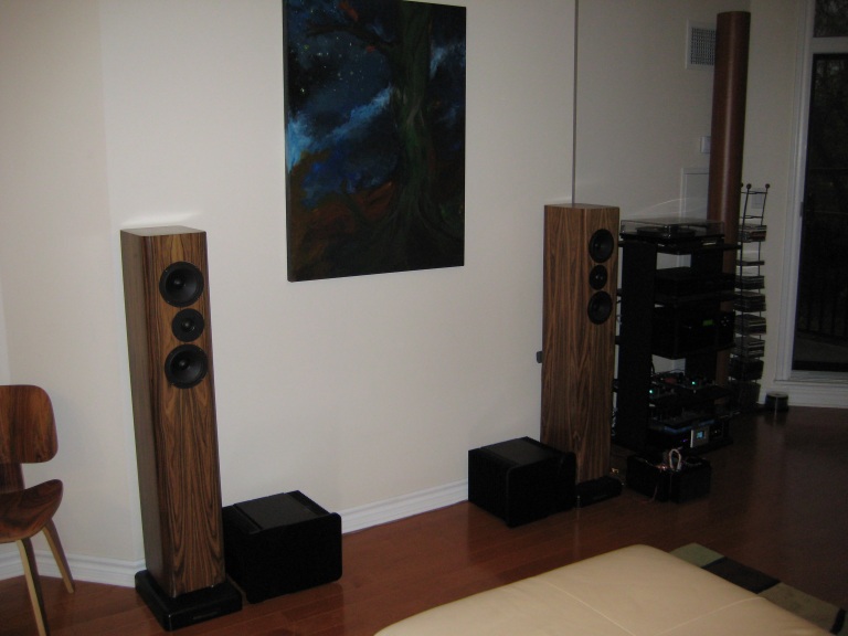

Saturday afternoon listening
Done and done!
I've got it on as we speak! The new Mogwai album "The Hawk is Howling" sounds excellent on the 180g vinyl release.
I really like this amplifier, but I've only got a few days of listening under my belt so I won't splurge on the details. It does sound good though, very very good.
I've attached a picture of my setup with the new F5 sitting on the floor off to the side. You can see my Aleph 2's beside Lynn Olsen's Ariels, and to the right is my equipment rack which houses the turntable, a BZLS preamp, the Aleph Ono phono preamps, and a Resolution Audio CD50 CD player. Behind that is my sonotube subwoofer with a 6.5" TB driver in a 40Hz tuned line. Kinda like a miniature El-pipo.
Needless to say I'm a big fan of Pass Labs stuff...
Three cheers to Nelson for another incredible design!
Owen
