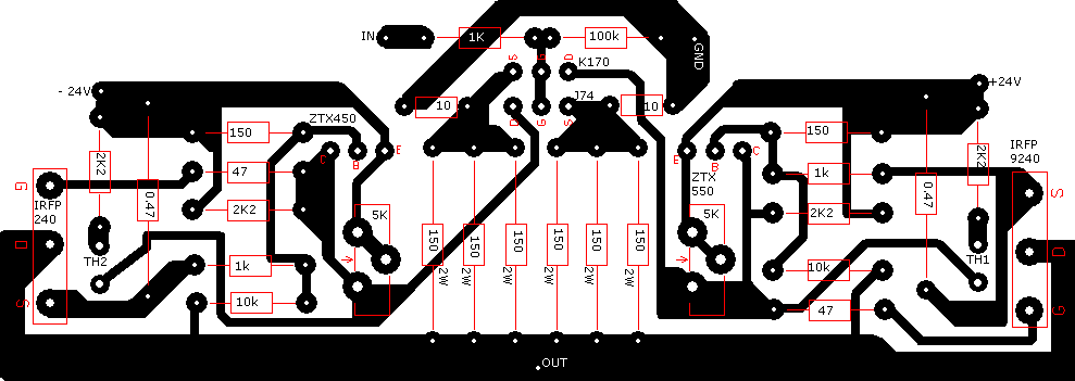

Wasim said:Thanks for the previous reply. I am using this PCB is it fine for F5?
It looks nice. I did not examine it carefully for errors.
Hi Nelson,
If you have time, can you just have a look and see the PCB in detail so I will start working on it?
Regards

Wasim said:
Hi Nelson,
Regards
I made that layout (post #965 in this thread). AFAIK, PCBs for two amps have been made with that layout and they are playing flawlessly.
BTW, you can use 5K NTC instead of a 4K7.
Oh Thanks Juma,
It's really nice. I start working on that. I am not an electronics guy but this is my third project. I just want to ask one thing here I found IRFP250 and IRFP9240 can I use them? Thanks in advance. by the way this PCB is excellent.
Regards
