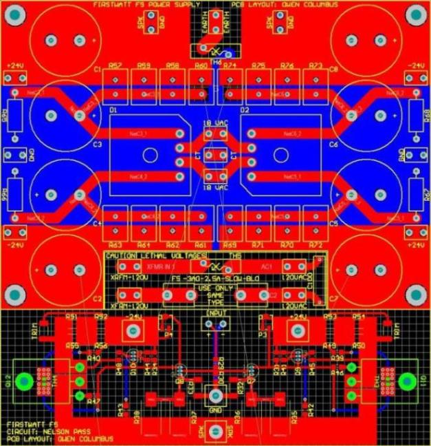

I've attached a final screen-shot of the PCB I'm sending off to be made on Monday. I've only included the PS and one channel, but I managed to fit two more channels below that.
I got rid of the B1 circuit, and used the space for an extra F5 channel, so I'll have five power supplies, and 15 channels total. I'm keeping one PS and two channels for myself.
Now, I have a bone to pick about the whole "JFETS must be touching thing". I've read over the whole thread, and some people have done this, while others haven't (namely Nelson himself, Jackinnj, etc).
If the point is to keep the JFETS at the same temp to prevent thermal drift, then I suggest the following:
1. If they're both mounted on the same board, in the same chassis within 1" or so of each other, they're pretty likely to be very very close in temperature anyhow.
2. If the dissipation of the device itself is causing the temp drifting, then putting the cases face to face probably leaves a good 100 degrees C/watt difference from one die to the other, so I doubt it's doing much.
Can someone comment on the legitimacy of this practice? If people are making a mess of the most critical portion of the layout just to get two JFETS to touch for no reason, then it would be nice to make it clear. All the amps built without contact seem to be working just fine. Thermal stability seems to be dominated by the proper use of the thermistors, and not by the JFETS.
I've tried to optimize the following on my boards:
1. High power traces are as large as possible
2. Input is kept a good distance from output
3. Thermistors are very well coupled to the FETS
4. Fets are nice and far apart (about 5")
5. Feedback path is short and runs directly from output to JFETS.
6. Distance from gate stopper to gate is very short
7. Star grounding used on the F5 channel itself
8. Shaped ground plane used on PS
9. SMD parts minimize lead inductance/signal length
10. All thermistors, fuses etc... included on PS - just add a transformer!
I'm still open to any comments on the layout, so please let me know if you spot anything. The boards are going into an old school pass labs style chassis with heatsinks on all four sides. One channel will be on the left, one channel on the right, the PS board on the front heatsink, and connectors will be on the back heatsink. XFMR will wit in the middle, and will be well shielded with copper.
Owen
(Again, sorry for the terrible screenshot. 104kB is not an easy target to meet. If anyone wants a proper PDF with the schematics and layouts, just email me and I'll send it to you)
