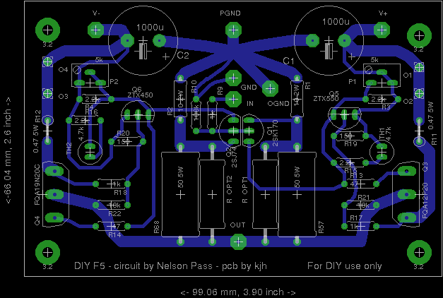

@khaho: since nobody gave you a bit feedback on your board, I jump in, even if it's late.
When layouting a board, usually one routes first the ground, then the rails, (then NFB-path) then the rest. Reason is to have full freedom for the most important parts, like to use space eating star grounding.
Said that your grounding is really a mess; you don't use star grounding and you connect signal ground directly into power ground. That can make problems.
Trace width could be increased a bit as well.
However don't let that stop you from making that board! Go for it and use the tips next time.
Have fun, Hannes
PS: I didn't check your board for errors ;)
Actually I did follow your order of making the tracks, maybe the result just is bad.
Thanks for the feedback, I will redo the grounding in next variations, if I will make those. I might even patch the board to have more star like grounding, if needed. Anyway the ground area is very small, because of the circuit design.
I was thinking that 32 mils would be wide enough tracks for the small signal part, maybe it is not. Anyway my layout is much worse than some others posted here, but I think that it will work good enough for me.
32mils is fine for low current tracks (mA). I can't see what you used for the high current tracks - 100mils? Would be fine as well.
Connect reservoir caps always in a 2 line fashion - one track feeds it, the other goes from the cap to the sink to avoid unnecessary voltage drops.
Have fun, Hannes
Is this one better in grounding ? Otherwise it is of course worse than others.

Hi khaho,
I would suggest that you seperate the "PGND" (for the 2 1,000uF caps) and run a seperate wire to p/supply star earth and this leaves R1,2,10 connected to "GND" only - just a small thing, but good results and easy to do with your posts already there.
Something looks a bit strange about the different connections of the TH1 and TH2 and the ZTX trannies - Not sure, sorry.
A possibility? Add an optional Cmultiplier to replace these caps [IRFP240,9240 - 220uF+47kR on gate - 1uf PP on output] - better result.
Looking good.
@khaho: yeah, that's quite nice. However remember that in star ground or star power the connection (wire pad, connector, whatever) is always in the center of the star. That is to avoid, again, voltage drops due to large currents from the output stage.
Signal ground is usually separated from power ground, however a common star ground should work quite well too.
I leave the fine tuning - if any - up to you.
After all it's about building amps and enjoying music and not about making the perfect board-layout ;)
Have fun, Hannes
PS: last comment: maybe you want to use larger pad distances for the resistors? Seems you use 12mm for 10mm resistors, which might lead to problems with broken leads or inner contacts when bent so strongly. But not really an issue since you are not going for mass production :D
GNDing
@khaho: V+ and V- are now fine.
But grounding is still a real mess. You need more than one GND stars. One is at the connecting point of main elkos. The other is on the PCB with input circuitry - R10, R1, R2 going to the input RCA. From RCA goes to nearby chassis and from this chassis a thick wire to the main elkos star. Also speakers GND is taken from this elko star - take care speaker currents NOT disturb other grounding currents. Speaker wire from PCB goes twisted with 1000uF elkos grounding and with V+, V- wires as far as main elkos. From main elkos it continues twistwed with speakers GND to output terminals.
This is how I understand grounding. Members with more experience please correct me if I'm wrong. :att'n:
There is already thermistor connection to chassis ground from PSU part of F5, so I dont think that GND of elkos (separated from other grounds in PCB) should be connected there again, that would be one ground loop. But if other ground is separated, should that be connected to chassis ground, so it would be tighter in chassis than the PSU ?
I dont understand why speaker ground wire should be twisted with PSU wires ? Maybe because I dont have the experience ?
khaho said:
There is already thermistor connection to chassis ground from PSU ....
Sorry, I don't understand the need for thermistor. But, sure - avoid GND loops.
The currents are flowing in loops and we must keep these loop areas as small as we can. Speaker GND wire is not twisted with PSU wires, it is twisted with SPKR OUT wire starting from main elkos. SPKR OUT from PCB is twisted with PSU wires & with 1000uF elkos common wire up to main elkos GND star.
