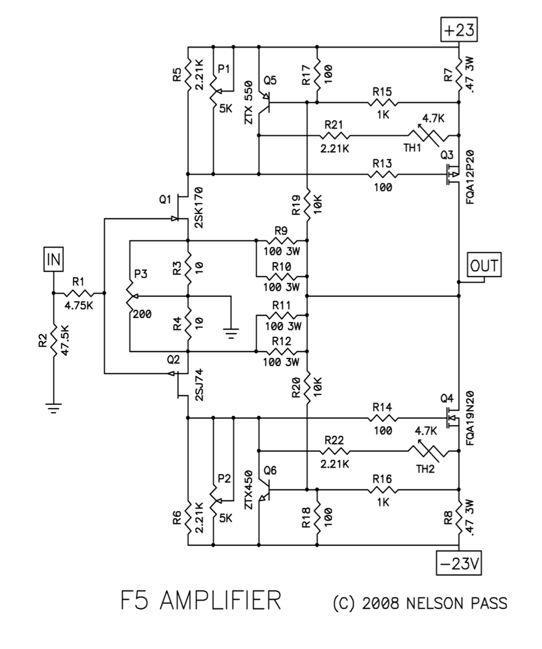

I am still not sure if the resistor is in the right position. According to the document of David (thanks by the way) HBRR and HBRL should be placed between input gnd and speaker gnd.
R10 and R7 in Figure 5 are the input resitors to gnd, those are the 47.5K in the F5 schematic. So, at the moment i just placed the 12Ohm resistor in series with R12, and not as it should be?
But, I think i cant put the resistor at the right spot with my PCBs (V3 of the diy audiostore) ?

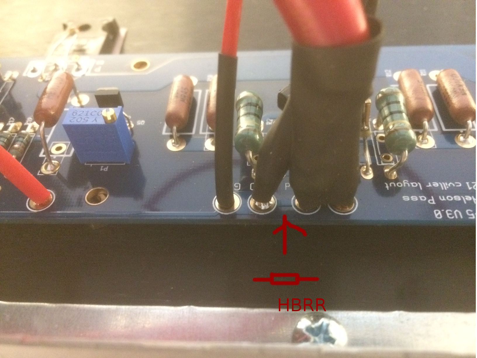

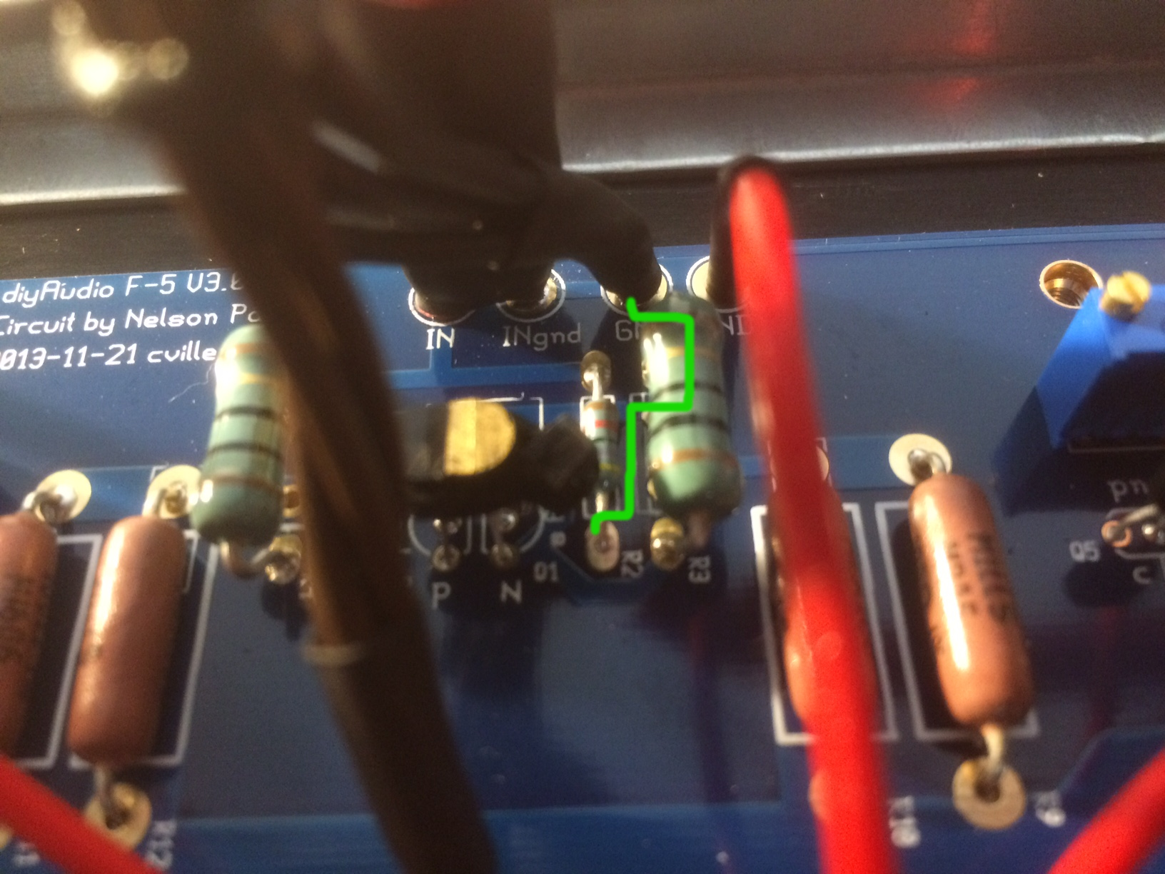

Can you show a pic of the PCB traces in the area where decoupling ground, PSU Zero Volts and Speaker Return are coming together?

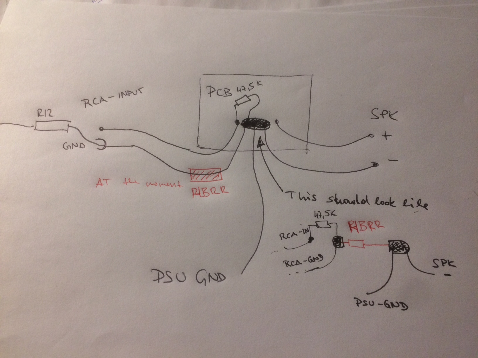

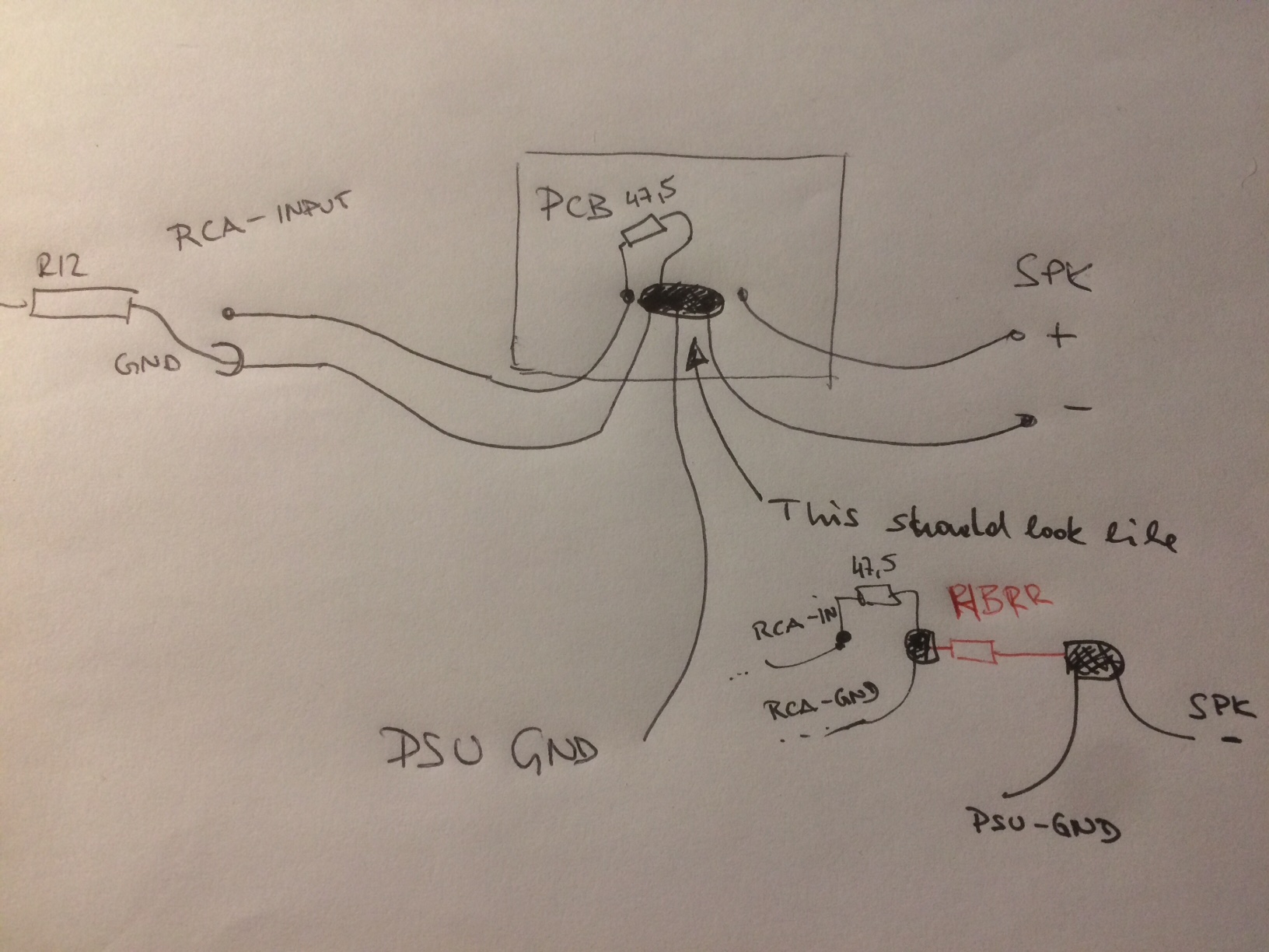

:(:(:( ok maybe its not that easy. Due to all the cables i tried to draw the pcb connections. When i remove that connection I was thinking about and add the HBRR, then there is no connection between R2 and In-GND anymore. Thus I have to unsolder R2 and put it as in the drawing?

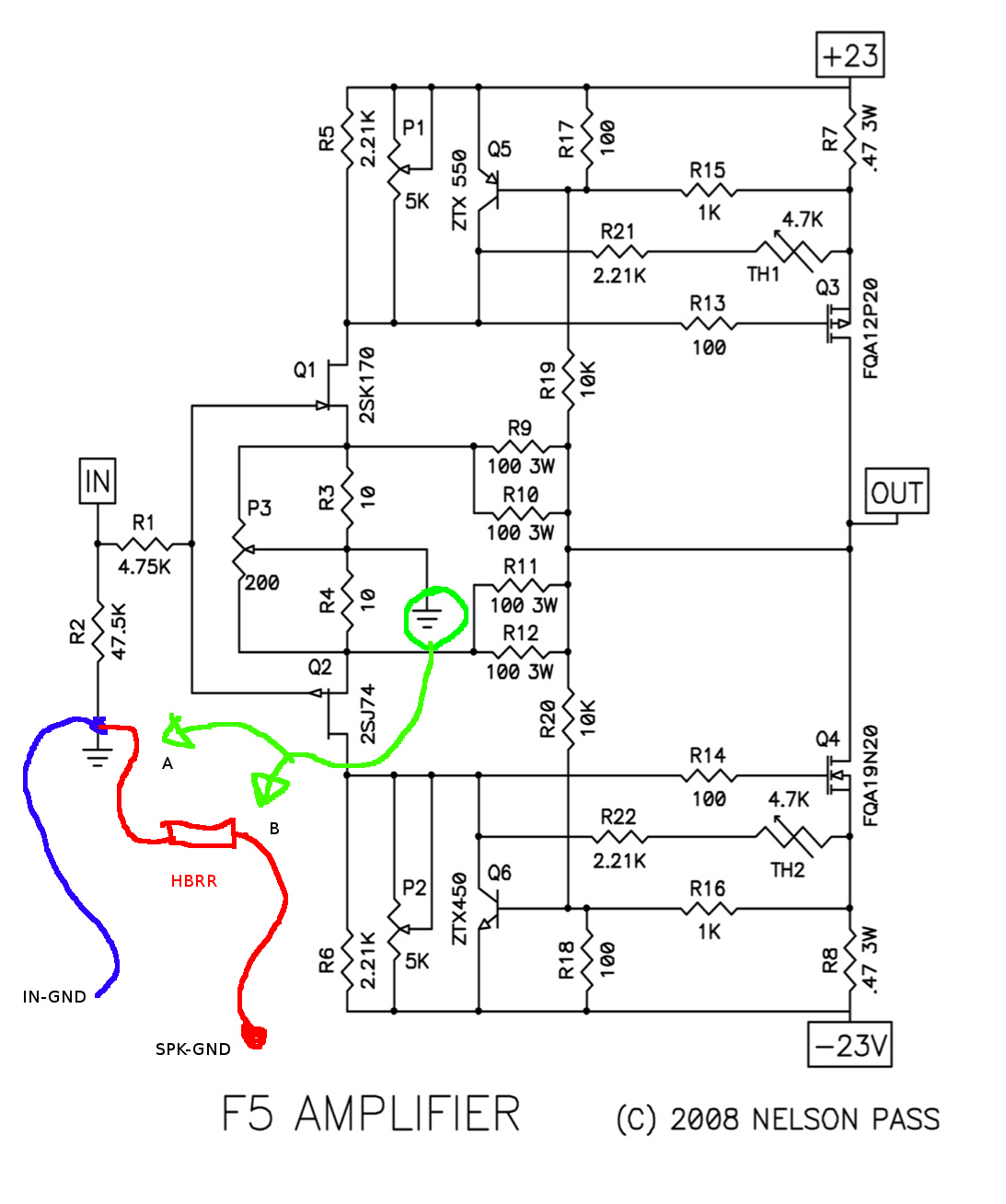

here a photo, and in green the connection that would be wrong then.
The question I was asking before refers to this schematic:
Do i need option A or B?

Now I see R3/4 in their new locations.
The Power ground/decoupling ground/speaker return are all on the Main Audio Ground.
The Signal Return is separate.
The green arrow to B looks better. It takes the feedback from the speaker output back into the MAG
This is an example of using gnd for all points that are actually doing different duties. We were discussing this elsewhere.

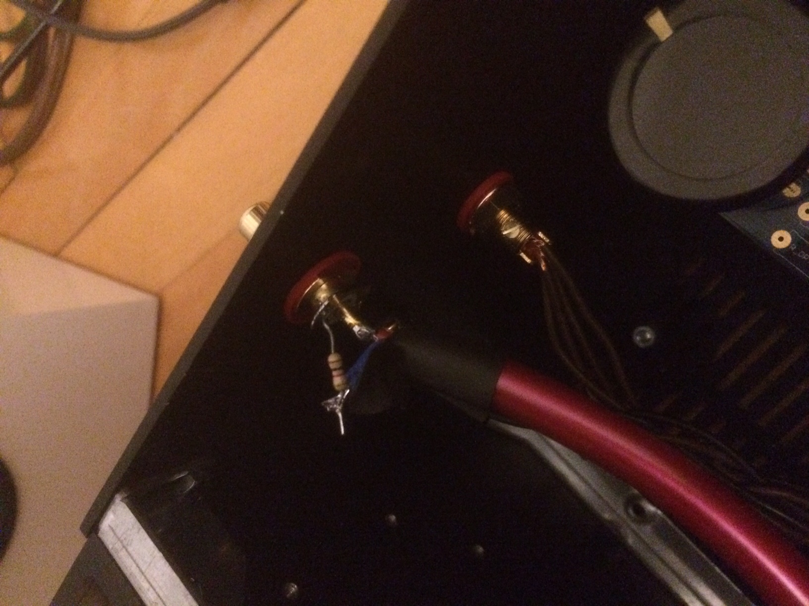

soo, I applied the changes on one channel.
Similar as before, I can now already hear a hum when I connect only channel with the preamp. (not as without the 12Ohm resistor only when i connect both channels with the preamp)
I will now also add the resistor in the other channel, but I don't have a lot of hope... :/
yep, still a hum. When i connect one channel with the preamp I can hear it, it doesn't depend on the side.
It's really weird, as I did not observe this behavior without the hum breaking resistors? When I connected only one channel the amp was totally silent. Only when I connected the second one I had the loop, thus a hum...

So, I also tried 82 Ohms.
When its in one channel: I connect one input (the one with the hum breaking resistor) with preamp: i can hear a really loud hum on this side of the speaker. When i also connect the other input with the preamp the hum on first side gets a little bit more quiet but it is still louder then without any resistor. A little bit surprising is that the speaker without the hum breaking resistor is totally quiet.
With a resistor in both channels: I hear a hum when i connect the first input. when i connect also the second one i hear a hum in both speakers.
I also tried with a different preamp, the same effect, so I still think its the cross channel ground loop. Maybe the resistor is still at the wrong position? I am not sure, don't know what to do :(

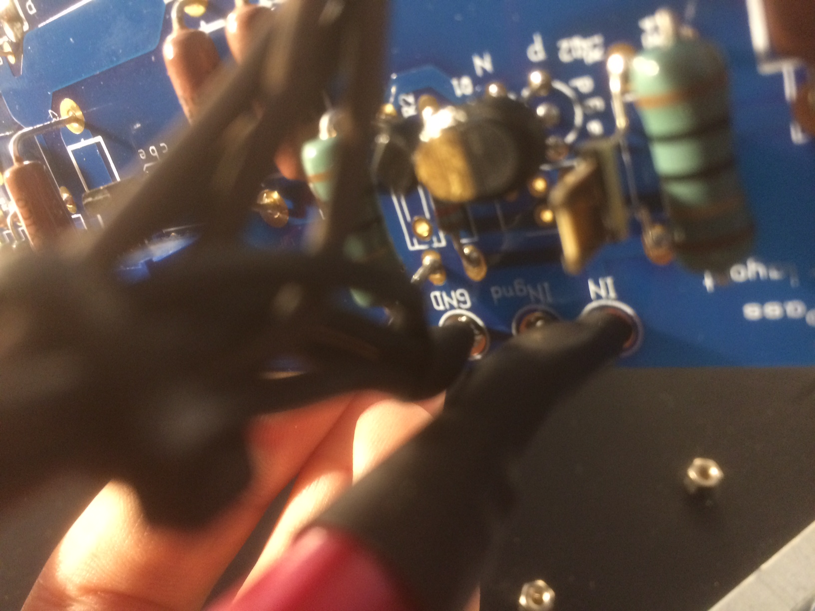

go back a stage.
Insert zero ohm dummy plugs into the inputs. Measure the Hum+Noise (on the 199.9mVac setting) at the output and the output offset . Report your results.
I do this again with zero HBRR and HBRL, right? so just put the input signal to GND and measure the output?
