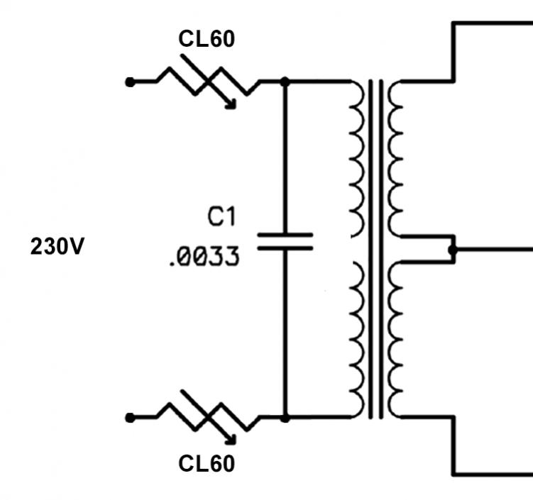

A single CL60 gives too low a value of added resistance for use on most 230Vac transformer.It could be the soft start board - best to use CL60...
CL60 works for many sizes of 115Vac transformers.
Two series connected CL60, or select a higher resistance NTC, for 230Vac duty.
Is it ok to have 2 CL60 in series with transformer mains;
One on phase, brown, before entering xformer;
The second one, on neutral blue, on the other lead of xformer ?

Ok, so i used 2 CL60 (although there is only one in the main line of the PSU in the F5 manual?).
I removed amp boards and checked the voltage of the psu under load. Indeed it "breaks in" a little bit, but not like the behavior i can measure with the amp boards.
So here are the values i measured, where Vr is the voltage accross one of the resistors that have 0.5Ohms of the CRC bank:
load: 180 Ohms: V+: 23.4V, Vr: 17mV || V-: 23.5V, Vr: 17.5mV
load: 90 Ohms: V+: 22,8V, Vr: 32VmV || V-: 22,8V, Vr: 32mV
load: 45 Ohms: V+: 21V, Vr: 60mV || V-: 21V, Vr: 60mV
According to my calculation, for example in the case of 180Ohms the load current is 24V/180Ohm = 133mA. I measure 17mV at one CRC-Resistor. I have 4 in parallel results in 0.125Ohms. This leads to a current of 17mV/0.125Ohm = 136mA. That sounds good?
So, i hope those results tell me that my psu is working correctly, am i right?

I'm not sure. Consider the 45 ohm load case. Your rail has already
dropped to 21V (from 24 or so with no load). This gives a current
of about 21/45 ~ 0.466A (From Vr , 60mV/0.125ohm = 0.48A). Now a
single channel of F5 at the standard bias will draw about 1.3A, which is
almost 3x the current in your 45ohm test. If this trend on your PS
continues, the voltage will drop significantly more.

the way you have shown the two CL60 is correct. They are in series and that will work.... So, this wouldn't do the job ?
Best,
nAr
But I don't like that one CL60 is at a different Line voltage from the other.
Officially and technically both CL60 are mains and thus both must be considered Live even when one is actually in the Neutral line.
I would prefer in my own build to have both Cl60 (or resistors) either in the Live line, or in the Neutral line. Not mixed.
