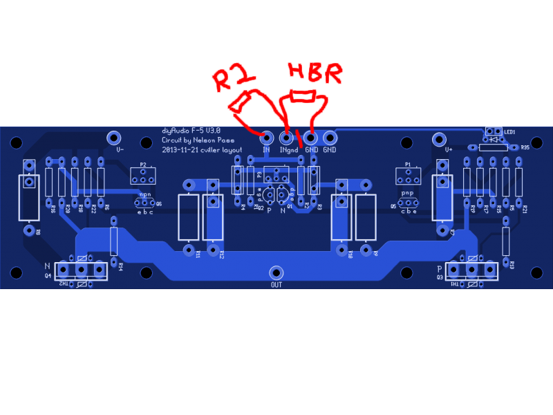

If you are sure there is a big increase in hum with the connected signal returns between the two channels, then it convinces me that this is the biggest problem. Adopt the HBRR+HBRL
If you are sure that the long interconnects with the shorted remote ends is completely silent, then that points to the internal wiring being correct.
It seems that it's the PCB designer, who should have told every builder that he designed the layout to suit mono-blocks only, who made the mistake.
Stereo/multi-channel amplifiers need a different arrangement compared to mono-block. But be consoled, 90% of amp layout designers make the same mistake !
It's only in the last couple of years that a few "wide awake" Members here have adopted the HBRR+HBRL solution.
I have not seen any other solution that effectively attenuates the loop/interference current.

I understand, too bad, i should have built mono-blocks then... Anyway, i will give it another try with the 10R resistors. It seems like someone had the same problem (post 14651), but I think now solution was found...
I did the last test (long interconnects with dummys and put together) with one hum breaking resistor, 12R (so not for both channels...).
The hum gets louder and i measure 1mVac at the output!
I really don't now whats happening, the resistor must be at the wrong spot, but I can't see why.
that's what i did. As suggested the input circuit must be complete, thus i removed R2 from the board, and soldered it as in the picture, furthermore i added the HBR.
this is the backside of the pcb

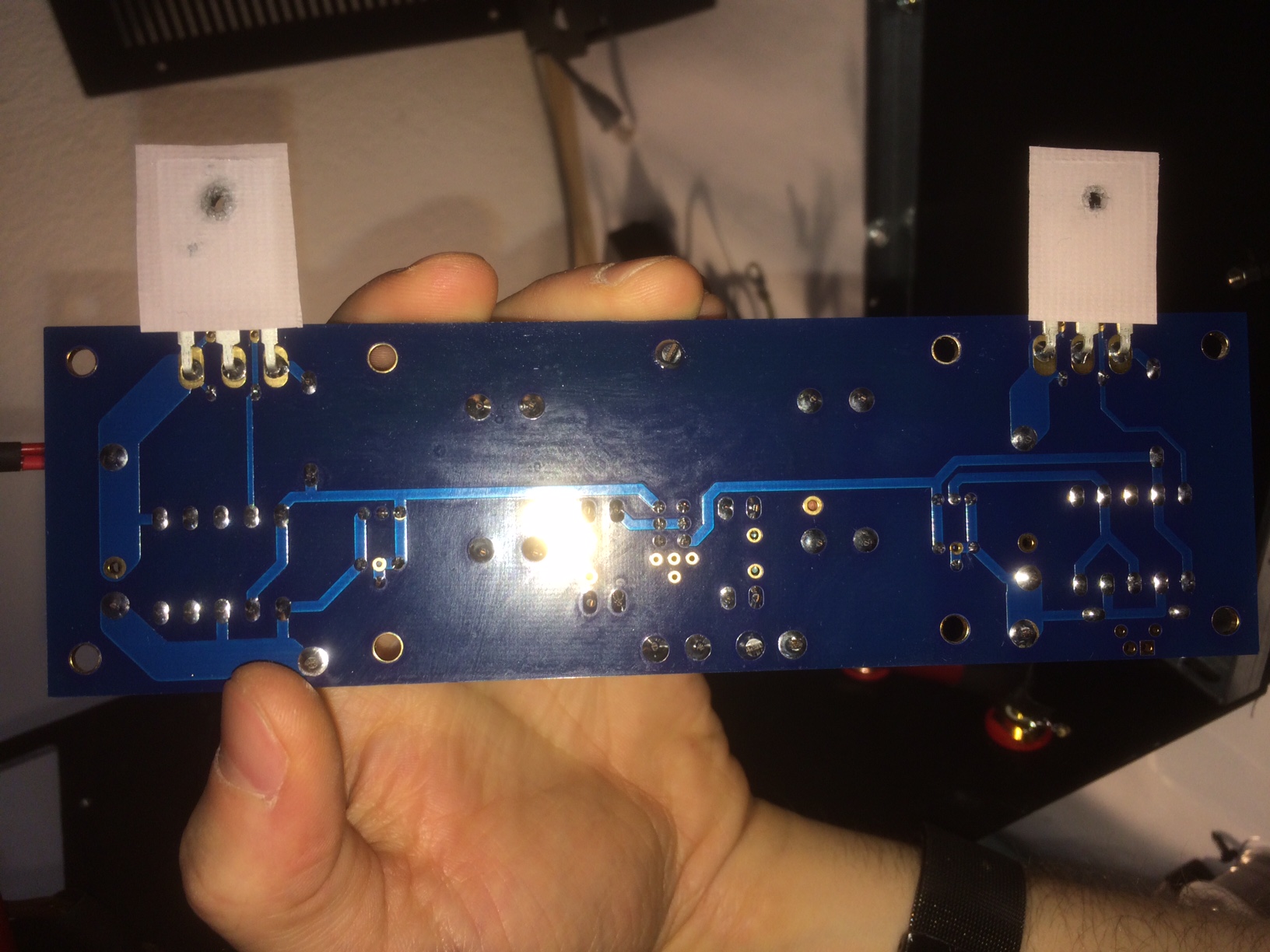

So, somebody here who can help me or has further more ideas where i have to place the hum breaking resistors?? The amp sounds already amazing, and I only hear the hum when my ears a very close to the speakers, but still, this drives me crazy, especially that nothing what I do has an impact on this
F5 - smoked R13
Hi all, after nearly four years of regular use, my F5 let out a soft, high-pitched hum on startup, then let the smoke out. I immediately turned it off and found that R13 burned up. Nothing else is visually wrong.
The only recent change made was a speaker protector board that was added a few days ago. It ran just fine for several hours of use after the board was added.
I'd appreciate troubleshooting tips from the experts here -- thanks.
R13? The 100R mosfet gate resistor?
well , you have 2+2 important transistors per channel , and +2 not so necessary ones
is it hard to check them all ?
Yes it is hard, and it heats everything up unnecessarily. I don't have transistor test equipment other than a 9v battery and a resistor.
It might be better to build a new board if there no way to pinpoint what went wrong.
