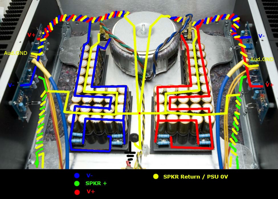

My primary objective right now is to make my amp work after experiencing a couple of setbacks, my main change this time around is that speaker return isnt going to the amp boards anymore but directly to the common point. And both rails are now directly connected to eachother, not shared via the longer 0V lines coming from both amp boards.
Last nite I went through the steps validating the integrity of the wiring, voltages were good, bulb went out and initial biasing went without issues - so as far as I am conserned the advice given and the path taken, appear to be sound. Building this amp is ment to be a learning experience, the next one will hopefully become even better. Any advice or thoughts given to me during this process have been appreciated.

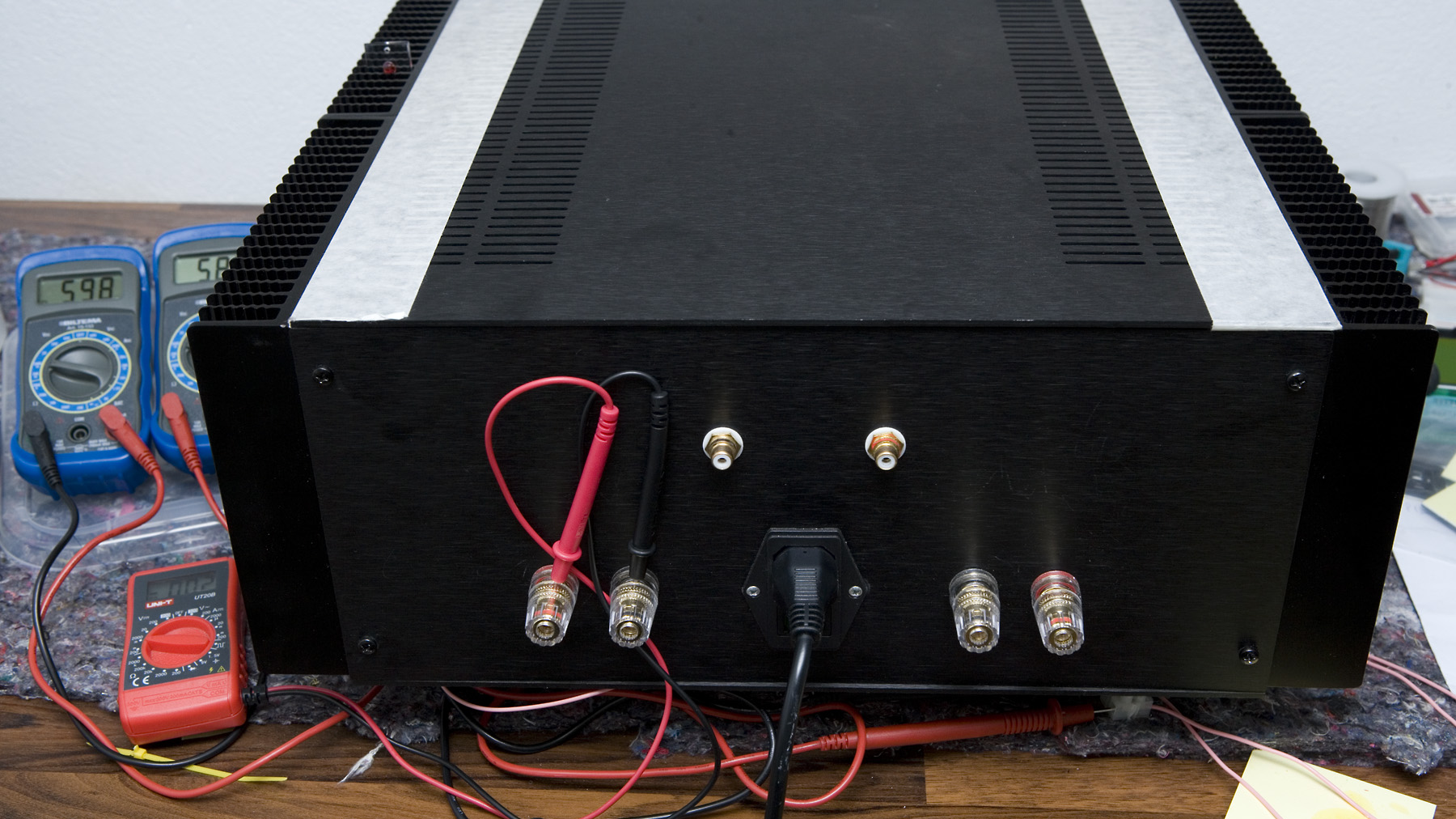

I have gradually increased bias since yesterday morning and am currently at 0,6V on both boards. The amp is closed shut, top lid rest snuggly on top. Offset both sides 0,0V +\- 2mV
Amp #1 is the good one, amp #2 is the new one.
When top lid is removed #2 bias drop 30mV and #1 barely at all.
Heat sinks on #1 appear to be marginally degrees warmer to the touch than #2.
With lid back on #2 rise back to set bias value.
I am able to firmly put two fingers on all mosfets for ~2s without feeling pain.
Will check tension to heat sinks, #2 might not be equally tight as #1. Keratherm used. Temp.meter on heat sinks indicate 36-38degC which is only about 16deg above ambient.

I have done one restart from cold, initial value on #2 0,460 quickly rising up to 0,620 before settling in at 0,598V. Max offset 10mV going down as it heated up.
#1 had a less sharp bias peak and is more stable around its bias point.

I have hooked the amp up to my receiver and connected speakers, its been playing solid for 2hrs now. It is slightly colder in the music room so bias seem stable in at 0,590V. Offset negligible :)
Volume appear to be down compared to my original amp but I haven't stressed the F5 yet. Speakers are DIY with a calculated efficiency of 100dB but I also tried it with B&W DM601S2´s. (Regular setup is Marantz SR5200 acting as pre with an Emotiva UPA5 power amp.)
It´s alive :D Now I´ll let it settle in (recheck bias/drift) before starting to optimise the new system :)

Regarding hum/noise:
I placed the F5 yesterday on my worktop with no signal input (input shorted) and hooked up one speaker to one channel.
Channel 1 = no audible hum/noise
Channle 2 = low audible hum/noise (this is the fresh board)
The only difference between the two boards (besides not being mirrored) is that their yellow GND do not go over the toroid but join on the right side of it before going to star ground. Hence channel 2 (left) have a slightly longer PCB return.
Sometimes a slight rotation of the transformer may affect this...also wiring location and so forth?
