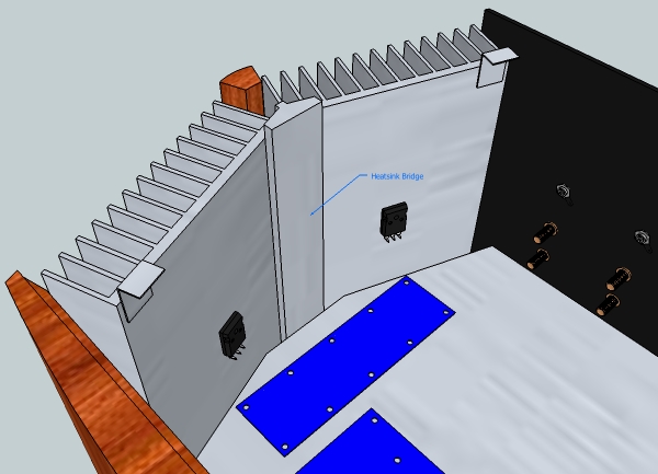

Do the heat sinks need to be thermally coupled to each other? Each output MOSFET will have 48 sq. in. of heat sink. The MOSFETS will be mounted off-board with short leads, so no need to bend the boards
The output offset is determined by the bias balance between the P and N channel devices, and the bias and temperature of the devices are quite intimately linked.
Good thermal coupling will keep the offset stable over time whereas separated sinks tend to show a bit of fluctuation as the bias moves up and down. This is not a temperature issue but is about the overall stability of the build.
Peter Daniel has posted a picture of some sinks which were separate but then he used some aluminum to couple the halves together. You can search the thread for his posts, there was some discussion of this issue during that time.
Thermally linking N sinks to P sinks is NOT equivalent to
intimately coupling N & P pairs.
The ideal power device layout would be an N & P pair in the same sink location and then all the parallel pairs spread across the sink.
Interleaving the Ns with the Ps gets close to that ideal.
Ns in a lower row and Ps in a high row is bad for Thermal Stability
Ns all at one side and Ps all at the other side is bad for Thermal Stability and worse than two rows.
Ns on a separate sink and Ps on a different sink is worst of all, especially if these are on different faces of a Chassis.

Do you mean the measures to effect the thermal coupling between the sinks, or the need for thermally coupling them at all?
I'm just a greenhorn here with zero amp building experience (except what I've completed so far on the F5), so it's all theory to me. So if you're saying that a separate sink for each output device is not a problem, I'm happy to go with that. (I can always add bridges later if their lack causes issues).
Given that they have the same size sink and are run at the same average
dissipation, they will tend toward the same temperature anyway.

OK, so the bridges may not be necessary, but they can't hurt and may be beneficial. They would provide additional structural stability to the chassis, and aid in aligning the heat sinks. I guess the determining factor is whether or not we (my son & I) can fabricate them with the tools that we have...

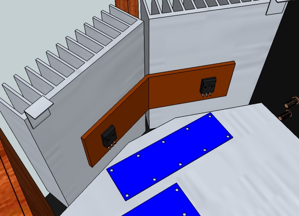

I have a 11x6" copper bar of 8mm thickness connecting two sinks of a F5 Turbo build.
It is able to handle 20W of device dissipation (about 150mA on 4 devices on 35V rails) at 30 degree temperature rise. All by itself The good thing about copper is that it will soak heat very quickly and offer a larger surface area to the underlying sink than the devices mounted on it, which somewhat reduces the impact of two thermal junctions.
Your first idea looked a bit better overall, but I would listen to the master's advice on linking the heatsinks and whether it is at all required.
I'll try the build w/out the bridge, based on Nelson's confidence in his design to compensate for the offsets Assuming the amp works at all, if there's any instability detectable (and, at this point, I don't know how I'd analyze that), I can add the thermal bridge at a later time. This latest solution has the benefit of being easy to fabricate; just gotta put a 40 deg. bend in a small slab of copper (rather, two slabs).
