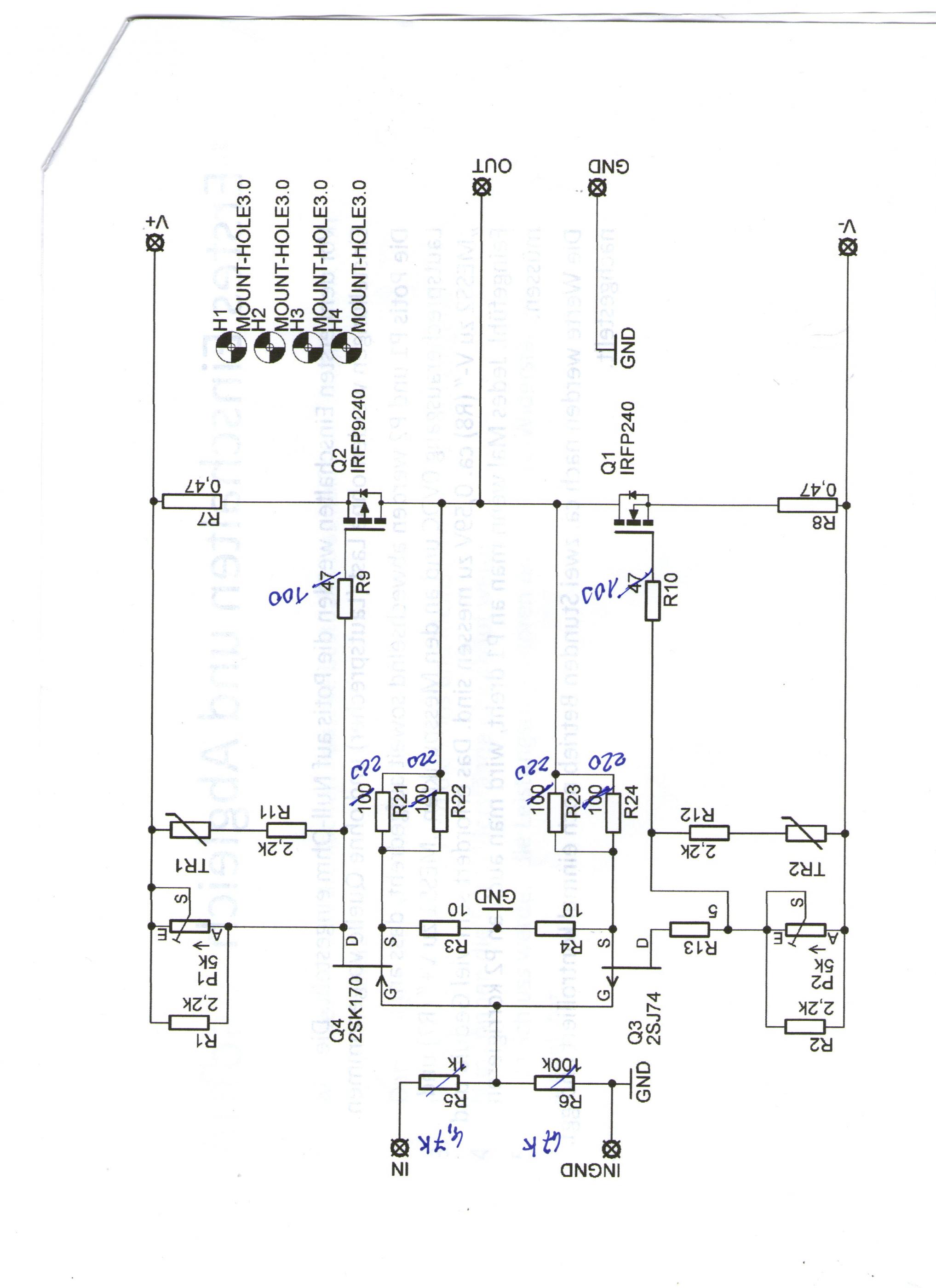

I only have a small problem :
in a channel can not get over 0.52 Volt across R12 . I do not understand if the problem is in P2 or Q2 or Q4 . Once I read the answer to this problem , but I can not find it.

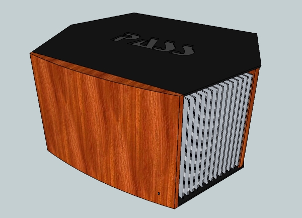

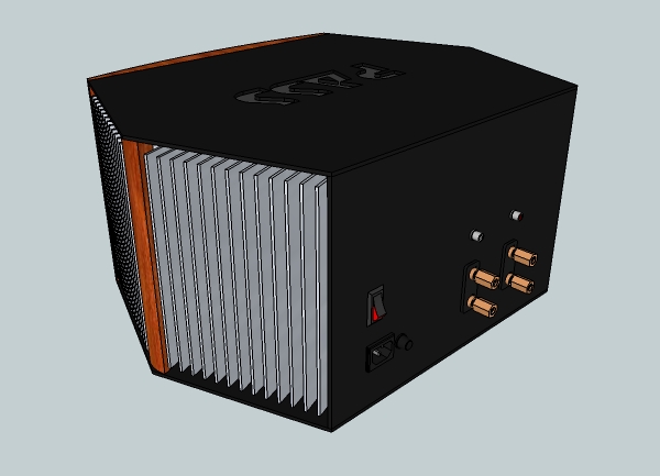

Here's my chassis design for my son's F5. Of course there's a big leap from design to successful execution, but this really won't be much more difficult than a rectangular box. Hope the use of the Pass logo in this manner is kosher.

This is
is 4,7k equal to 4700 or 47000?
Why did you change that?
To increase the RF filter of the capacitance inherent in the input jFETs?
Better to have added a fixed (non changing) capacitor across R6.
Keeping the source impedance lower usually gives the amplifier a chance for better performance.
Your gain and thus your feedback are changed.
The gain is now 220||220r / 10r +1 = 12times (+21.6dB). That reduces your feedback by about 6dB.
It also increases your sensitivity to 1.22Vac for full power (27W or 14.7Vpk).
Most sources are capable of driving your modified F5 into clipping.
Do you really need more gain?

oloppolo - I suggest you change the input resistor (R5 in your schema) to something near 1K. The 67K input shunt is fine. Everything else looks appropriate for a F5 with no limiter.
As Andrew says, with 220R feedback resistors your CD player should be able to drive the F5 to clipping.
