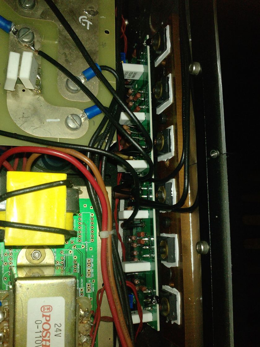

Picture shows my 3 pairs output fet F5.

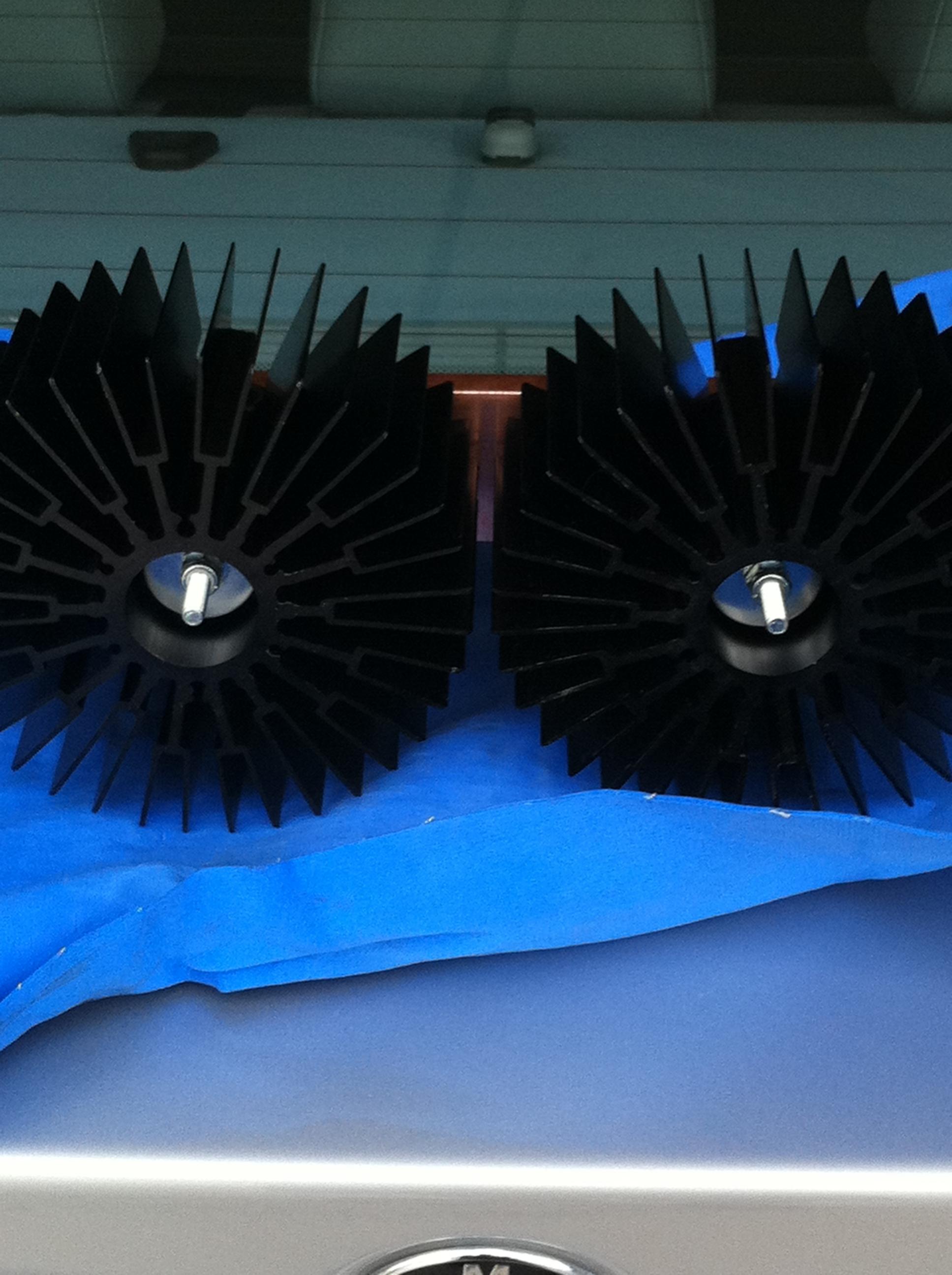

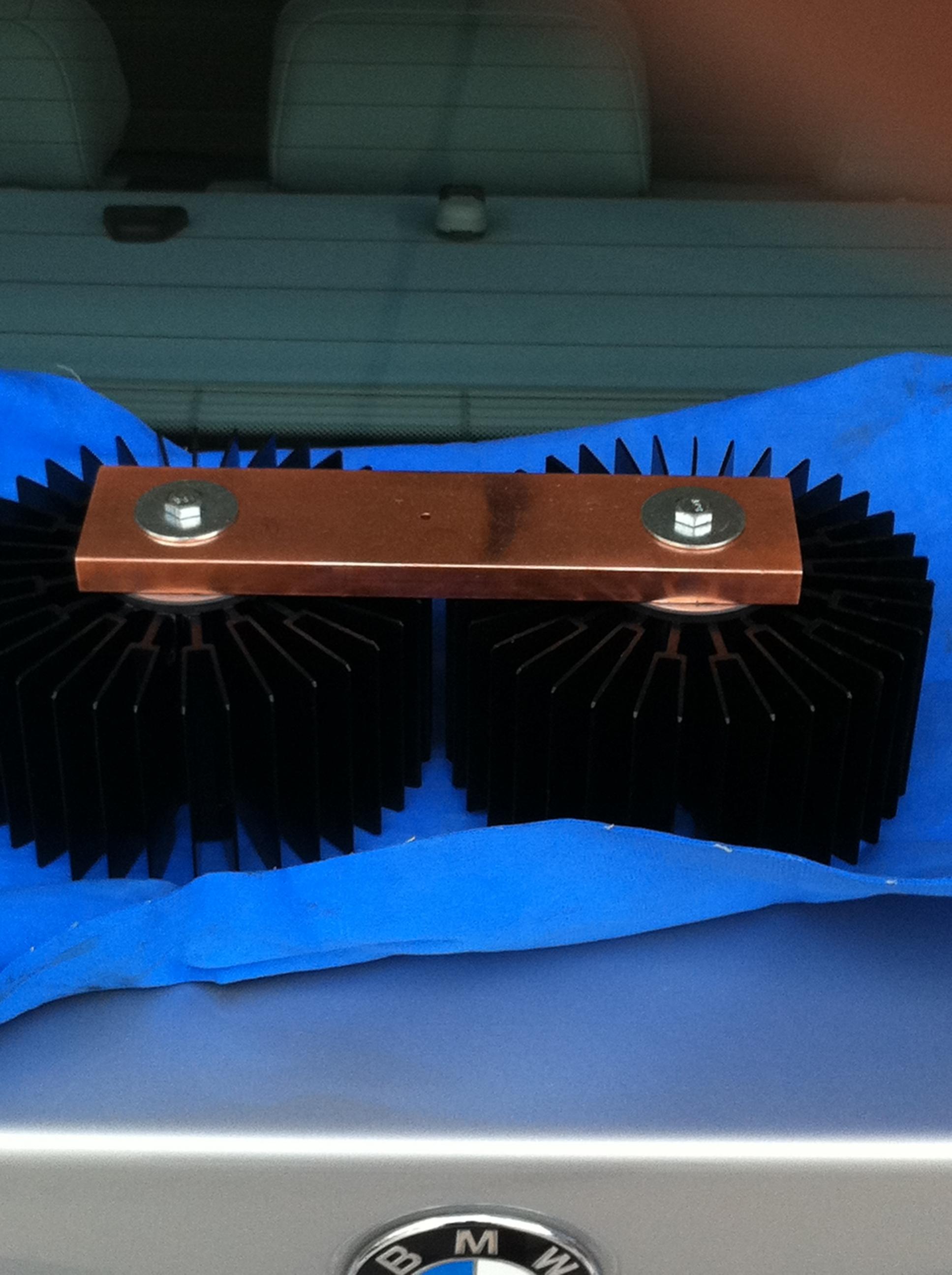

Copper Spreader
This is what I'm doing with my F5 copper to aluminum heat sinks. I have decided to isolate the output transistors so I am using 2 of these on each of my monoblocks. I am using diamond paste to attach the sinks to the copper bar. I will also be using diamond paste at the transistor on the copper bar as well. The heat sinks are mounted in compression using valve springs at around 180 psi on the inside of the heatsink. This should cancel out any thermal expansion differences between the copper and the aluminum. I also don't know too much about about thermal dynamics so I went for the brute force approach; not to mention getting a price break on the qty of heatsinks I purchased...
