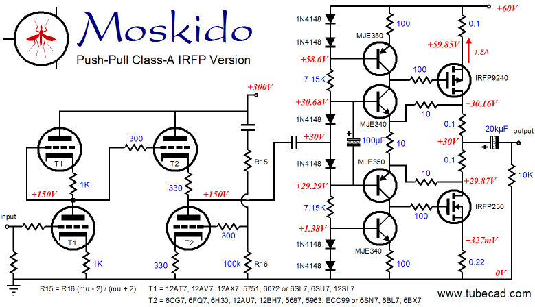

I have simple mosfet non-NFB source follower PP in class A with single supply rail driven by tube preamp. And would like to convert the poweramp to F5 as I like the sound better. For me it is worthy to make the change, so if you can please be so kind and tell me what should I change in F5 circuitry to make it work with single supply rail?

I'm not sure the F5 is a suitable candidate for converting to single supply rail because of the twin feedback paths, and the high level of feedback itself (will need the half-supply to carry large currents).
May I suggest you look at alternative design from the F series, one of the other circuits already operates off a single supply with an output capacitor.
