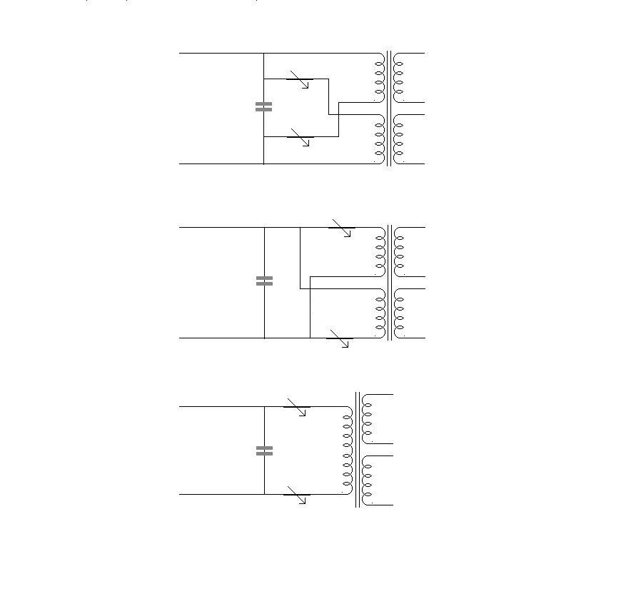

Just to clarify, with a single primary, one thermistor is series with each leg of the primary?
Like this?? --
Diagram 2 can be converted to diagram 3 by wiring the transformer up as shown in diagram 1 and adding a double pole double throw switch or a similar relay.
If the relay is triggered by a voltage comparator you can have the start-up condition wired as for 220/240Vac and when the comparator is sure that only 110/120Vac is connected, trigger the relay across to the NO positions and run the transformer at the correct voltage.
For a single primary just put it in series with one of the primary leads. Thats all you need. Doesnt matter which one it goes on and you only need one. Now be sure that you buy one that can handle the current. Figure the current by V/R when R= the value of resistance when it is under regular operating conditions, not just inrush. The CL60 should be able to handle any inrush current the F5 can put on it, but just in case you were looking at different thermistors I thought I should mention that.

Jack - Ok... Can you explain why? Isn't balance good? I guess I don't really know what exactly they are doing
If you are using a transformer with a single primary, all the current flows around that one primary so you just need one device. If you put the CL-60 on the secondary side you need one EACH before the filter caps of each rail.
This type of inrush current limiter has a somewhat high resistance when cold, when it heats up the resistance drops.
You have to be careful with the model of current limiter you're using -- if you're working with a preamp which is only drawing 100mA you don't use a CL-60 -- see the datasheet.
