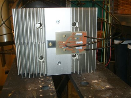

I wonder if the board can be 10-15 cm away from the outupt transistors . Pratically speaking may I have 15cm lenght wires ( max) between the output Fets and the board
stefanobilliani ... I use that approx. of wire between mainpcb, and output- board, without any problems at all.
Jesper.
Jesper.
Thanks alot . I am making little boards around the output chips now . In the F5 the jfet are both very close to the input , I am indecided if following that approach or put them more in 2 different boards each for Pchannel side and Nchannel side , close to the big chips .

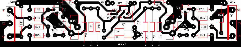

In post #781 ( http://www.diyaudio.com/forums/showthread.php?postid=1513301#post1513301 ) I presented a compact PCB layout for F5 with Q3 and Q4 placed very close to each other. Here is a new version (bottom view, 2 x 10 cm) with Q3 and Q4 placed far apart to allow easier use of two heatsinks per channel. Parts nomenclature is the same as in previous version. As Mr. Pass said, circuit is simple enough for p2p approach but PCB makes bias/DC offset adjustments easier.
Very nice , can I have a pair of them ?
