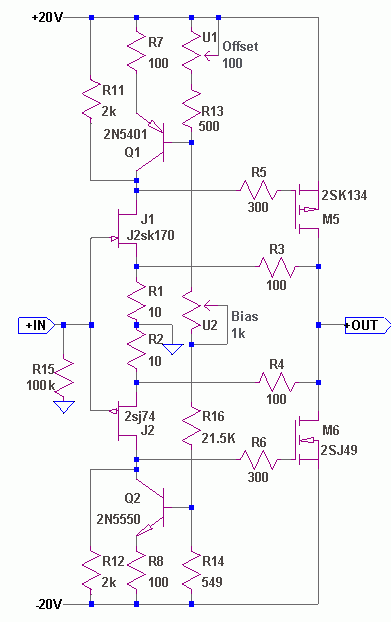

So 6.8 ohms output impedance is far away than a R2R design thus a lot of power "lost" for a common source output stage...
Also I could not get THD (1KHz) lower than 0.6% at 16Vac with 23Vdc power supply (at higher level it clipped but with a gradual rounded shape instead of flat) ... THD at low level was about 0.2%....is it consistent with Profet amp spec?
Unless using a hig hvoltage supply, I guess such a power amp design (Profet or F5) is not for Laterals... I have a few that I wanted to use...

1. How many laterals do you have? Parallel them. You will not need source resistors even if you parallel them, laterals have positive tempco already at very low currents (if I recall correctly, these have zero tempco at around 100mA.)
2. Q9 and Q10 are not really needed at this low supply voltage. Btw, with the biasing resis-tor values shown in your scematic, they allow for only 2.5-3V over the JFets. This is low for high input signal levels.
3. I am puzzled about the values for P1 and P2. The laterals need around 1.5 - 2V G-S for 0.6A bias. That means only 2mA through the JFets??
I think that your main problem is the low transconductance of the laterals and the low Gate Source voltage needed to "open" them. Both result in a much lower OLG than the F5.
I suggest you a workaround according to this schematic:
Current sources with parallel resistors instead drain resistors P1/P2. This allows to increase OLG despite low voltage drop.
I have used your cascode transistors for that
Use the F5 feedback arrangement, it allows for lower degeneration despite same source R.
The resistor values are starting values. No sim values! You have to tweak them, maybe massively.
Success, Tino

I have some questions before starting the building :
1) does F5 need a preamp?
2) may I decrease R11 and R12 slightly to 0,5 ohm?
3) If I use Fostex drivers as FE206 , are applyable the same tecniques described in " current source amplification " when my needs comes down to equalization? For Both F5 and F3 ?
edit: 4) Are ok 2sj109 here ?
thanks
thanks
No, it has enough gain depending on the sources
You mean increase? Yes, no problem.
The F3 and F5 are not current sources - the equalization
technique for current source amps will not work.
Yes.

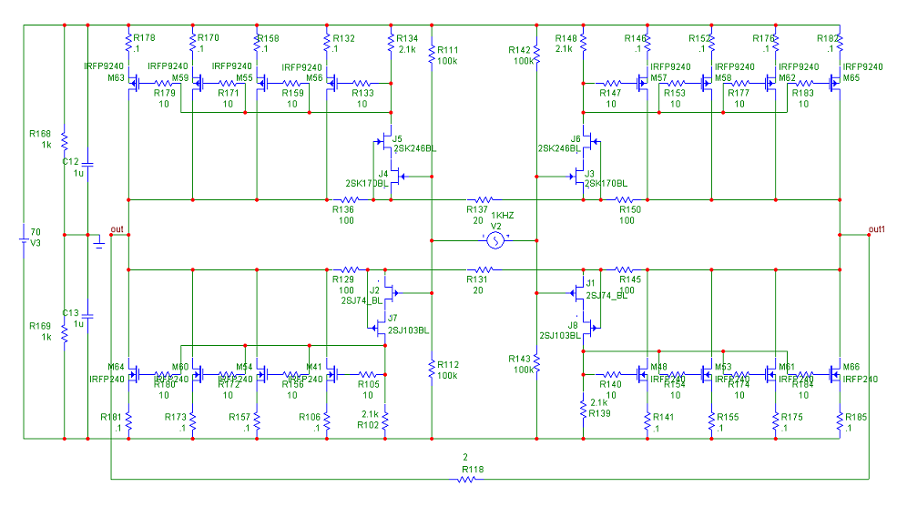

I have not had a too many chances to work on the balanced design (I've been busy with the birth my first child) but I can't sit still when it comes to improve my design.
I have also upgraded my computer to an iMac and had been re-organising my collections of design and application notes, and while I was browsing (for you windows users OSX has a 'cover flow' view of its files, which is just like cover flow for iTunes except it lets you browse through the front pages of all of your documents, pictures and pdf's, its a great way to look through your old articles) I re-found my Erno Borbely articles called "JFETS: The New Frontier". These articles talked about how to make the most of the JFETs and one of the examples was to cascode the 2SK170 with a 2SK246.
When I previously tried cascoding I cascoded the JFETs with MOSFETs but all the extra components with no appreciable performance gains put me off but the simplicity of cascoding a JFET with a high pinch off voltage JFET is very attractive so I tried it.
What I found was it enabled lower distortion while running lower bias in the output transistors (.8A vs 1.2A) and with the lower dissipation per device it would let me run more devices in parallel to get lower output impedance so the circuit can drive lower impedance load at low distortion.
This circuit can drive 120Vp-p or 900W into 2R Load at about 0.12% distortion.
Bandwidth is still wide at 230kHz and output impedance is about 0.03R
Of course the compromise is, the unit will still be drawing and dissipating 460W of power continuously so there will need to be huge heatsinks and huge power supplies.

That's not a compromise
cute idea
cute idea
Magura
