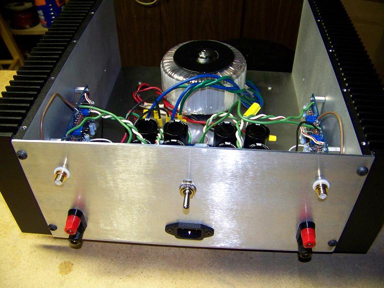

Here is my F5, built March of 2009, with Conrad MF35-151.5 heatsinks.
I could hold my hand on it for much more than five seconds.
I'm currently running two F5 boards in parallel per sink. Now that is quite hot.
But it does sound better. More current for the current hungry SEAS Thors (4Ohm).

Thanks for that. It looks like you have a pair of Chris Wujek's heatsinks :)
