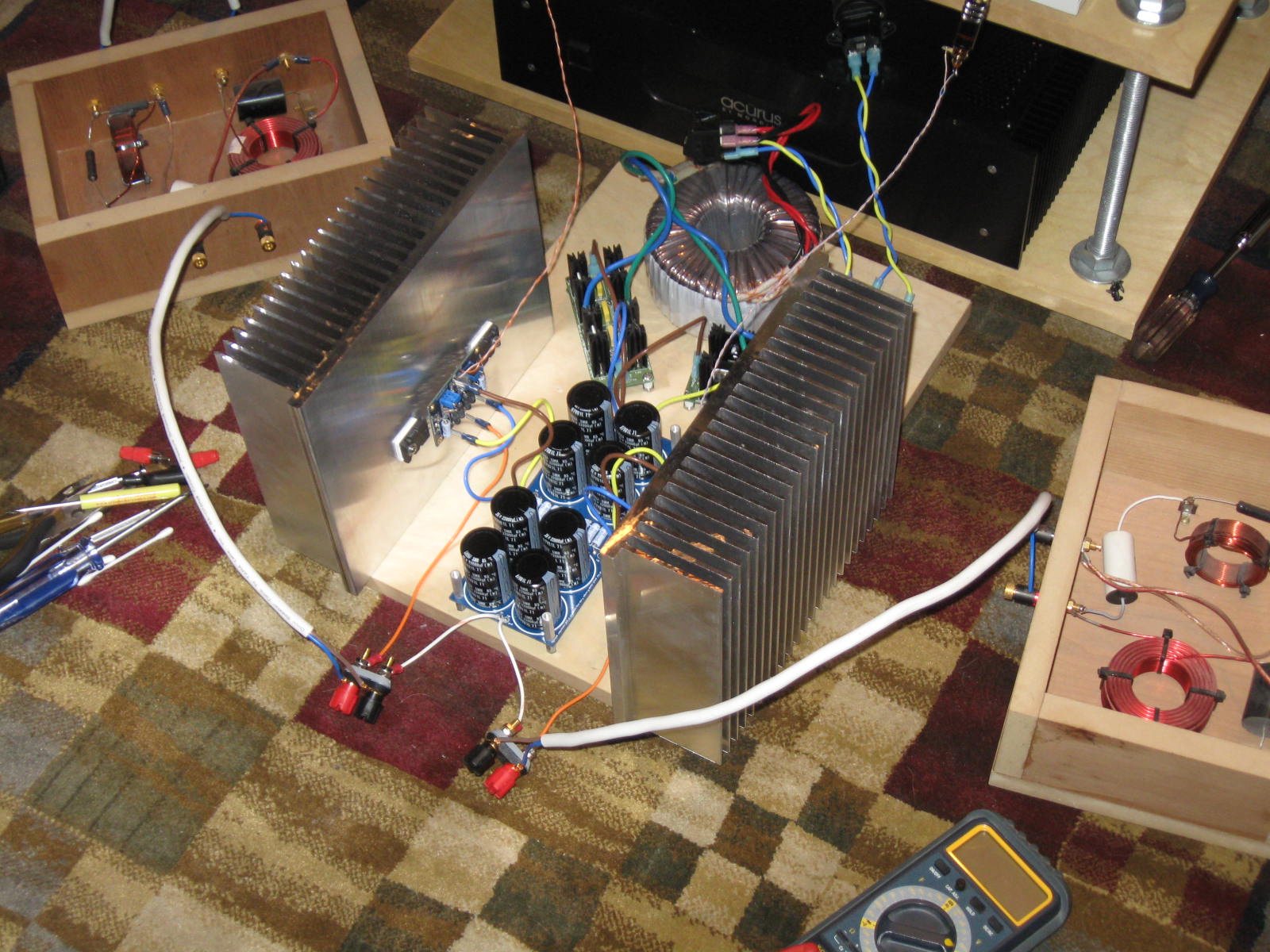

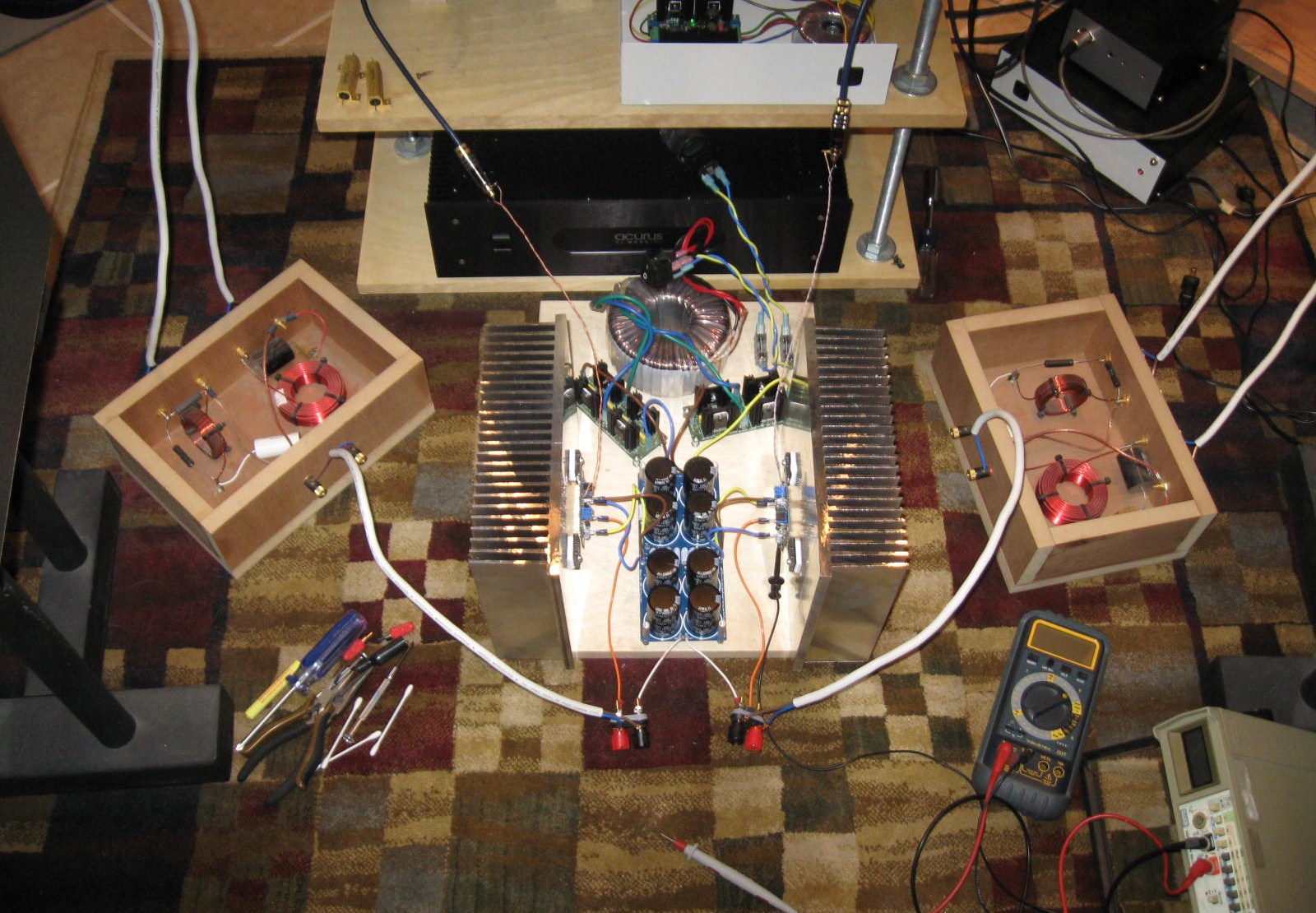

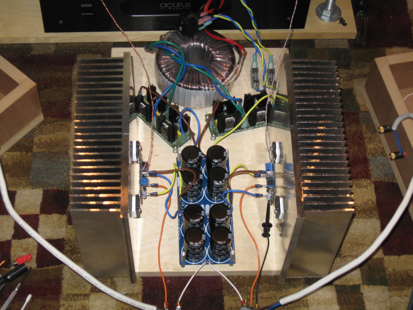

Some pics................
Just for s**ts and giggles I thought I'd post these.
Boards are Peter Daniels amp and Cviller PSU, real nice boards. I'm using Toshiba 2SK1530 and 2SJ201 for outputs with no thermal comp. and no overcurrent protection. It did take awhile to set the bias but it is rock solid now. I'm running the voltage across R11/R12 at .640 Vdc and thus the bias at 1.3617 amps.
Anteck transfo and Pers Anders RFB02 boards which I stuffed with MUR3060s and 10nf caps.
The AC wiring is temporary(probably).
The only problem is now that I have it "mocked" up and running it sounds so good that I have no inclination or motivation to put it in a proper chassis.

Yes. I had them on some of his 8.5" X 6" X 1" heatsinks and even at lower bias, .590/1.25amps I couldn't touch them for longer than 4-5 seconds.
With the larger sized heatsinks from him that I'm using now, 10" X 8" X 2", they barely get warm.
Nice, what kind of Silpads are you using under the Toshiba's? They look like a pillow, very thick.
They are aluminum oxide pads with thermal grease. I did not have any sil-pads on hand and these had been laying around getting in my way.
