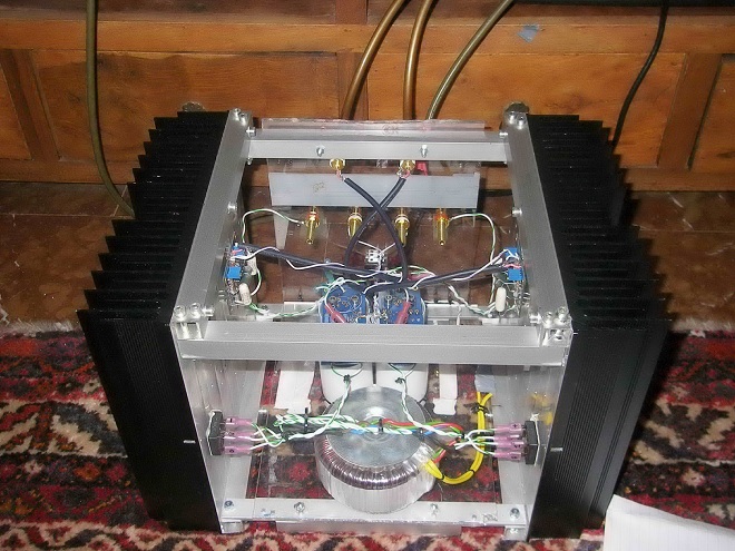

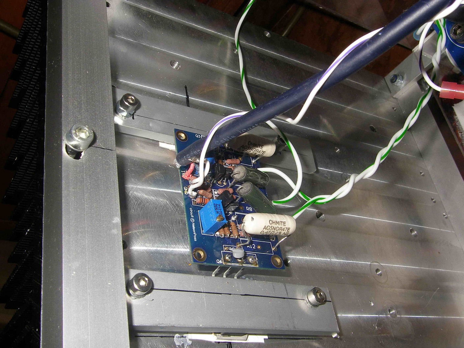

Renron, check the current running through the 0.47ohm resistors.
IF that is ok, and it is 1.3amps, then do what someone already said, put ur finger on the Mosfet and see how hot it is getting, if you can't touch it after the amp has been on for a while (better check earlier than that too) then ur not getting proper transfer to the heatsink...
My friend's F5 gets reasonably hot after being on for about 30mins or more, since it takes time for the heat to spread across the rather substantial heatsink...
so, I'm not sure what size heatsink u've got Renron, but maybe a jpeg will tell the tale?

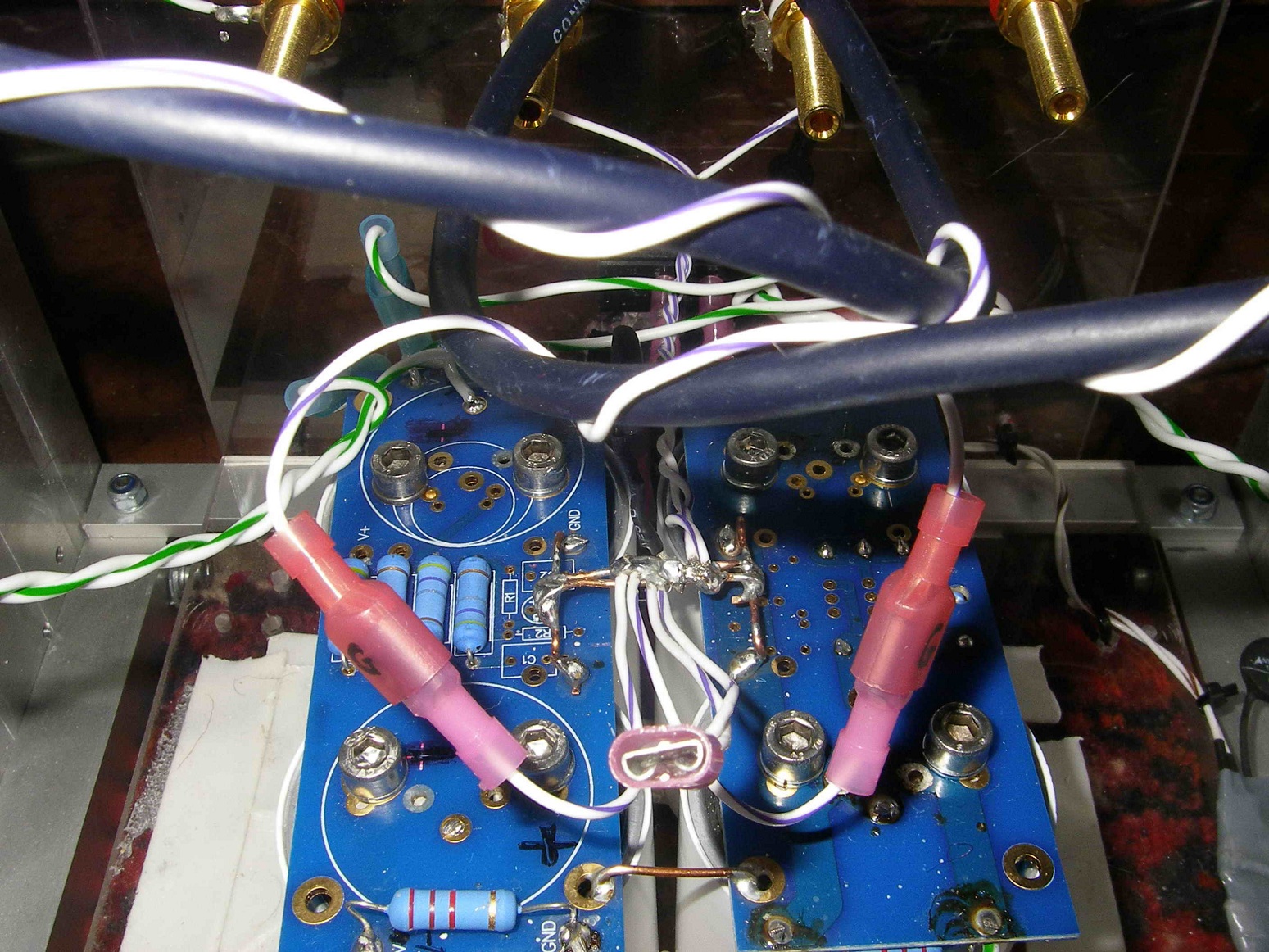

You cannot safely heat up the amp much faster just by changing the thermistor, and even if you made the 2.2k smaller and thermistor larger, you would probably not get that much shorter heat up time.
You can heat up the heatsinks with some other heatsource... ;)
btw your output terminal wires should not be wound around the inputs - you may get oscillations this way.

prooptiki, I can't tell from the pix which way is up. But if the transformer is down, you might consider putting the F5 board and output devices closer to the bottom of the heatsink.
It may not matter because you have a very large heatsink - but see how hot it gets after about 6 hours of being on, after the heatsink reaches some sort of thermal equilibrium.
Wondering if you milled the backside of those heatsinks or if they came that way?
_-_-bear
_-_-bear
Thanks, I am considering also to add two more channels f5 to the botom, but first I have to find out a good way to make my B1 buffer having two outputs!
I made some changes to the thermistors, now they are on the mosfets!
But still the heatsinks are too big, for about 36hours on power, the amplifier is colder than my cd player!!! I am going to try covering the heatsinks...
The heatsinks came as the are now, 40euros!!
