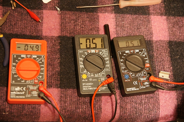

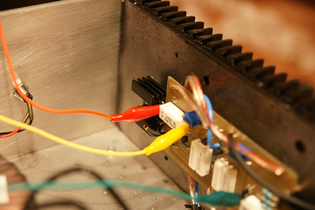

Hey all,
I fired up my F5. And the output devices do not seem to heat up quickly. So, I turned it off thinking something is a miss. My question is should these output devices heat up right away or is P1 and P2 set to almost zero preventing enough current to flow through the output devices? Not quiet sure. But, P1 and P2 only provide nominal adjustment and my problem is some place else?
Thanks in advance.

If properly set to zero for initial set-up (verify with meter), then no current will flow. It helps to have two meters when adjusting the pots.
Even better and safer use of the three multimeters, they are cheap by the way. :D so you quickly understand which of the pot in which direction to turn.

Hey all,
Thanks in advance.
Use a fused power supply when you initially set up the F5 -- and make sure that you have plenty of fuses. I use a pair of Tektronix DM511's which have internal 2A fuses -- and measure the current. They will initially conduct the Idss of the JFETs, as you adjust the potentiometers the current will rise and so will the heat. I do the initial setup with a programmable supply which is limited to 400mA -- when the dc offset is at a minimum and the amp is stable I switch to a power supply which will do a couple hundred watts and gingerly adjust the pots to get 1.3 amps bias and minimal offset. It's best to be patient.
