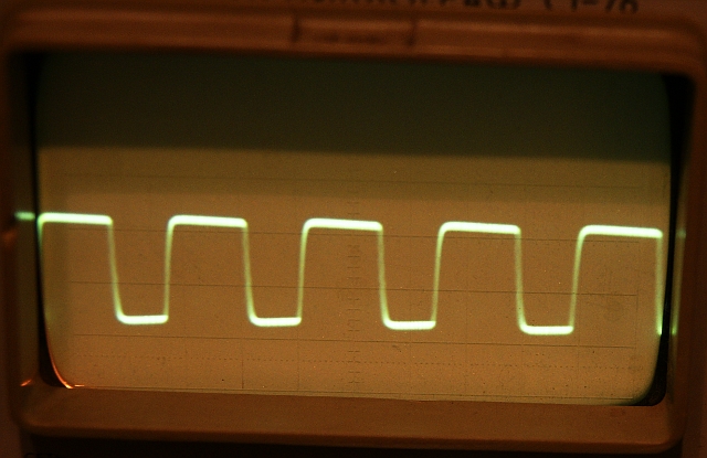

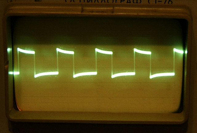

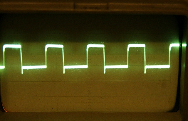

Hello,
Here I attached a photo of my F5 square wave picture @ 20kHz (approx.10R dumb load) and the original square wave @20kHz directly from generator to scope. Also for compare here is Leach amp square wave picture@ 20kHz. What causes these peaks F5 picture?
Is it a generator failure which is old maybe? Or, f5 does not work as is necessary>? Sound of my F5 is great IMHO.
Thanks in advice.
