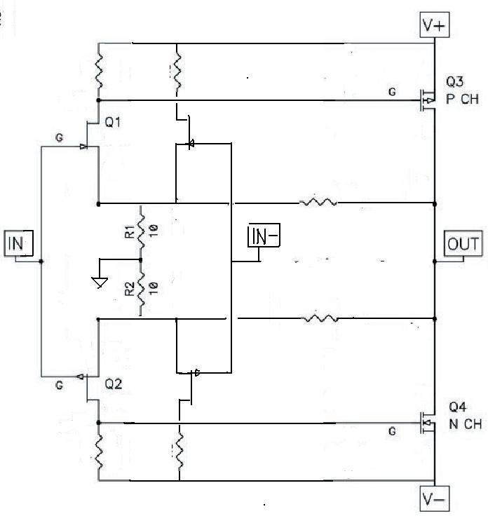

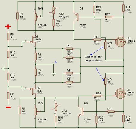

Balanced input F5 ??
Could someone take a look at this mod and comment?
I have a balanced source and would like to feed it to the F5.
