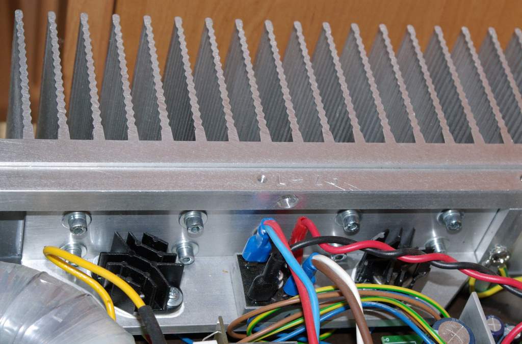

cool beans guys, thanks. i've never had to deal with this amount of heavy thermal management before.
are you suggestion that i have a screw loose?
good point, i can see where the base is restricting rising air flow.
... and maybe one more screw in the middle too... or am i wrong?
If not he can always open up the mounting bases by sawing 1" off and put some real feet underneith.
I will estimate that it may increase or decrease efficiency by maybe +/- 20%
But its a wild guess and depends on design
But if you control and increase up upwards airflow in the "tunnel" you have between your heatsinks, it might be very effective as a "pull motor" fore outside flow
Funny to think that even to close in the heatsink may improve airflow and effectiveness, if it can "breathe" properly

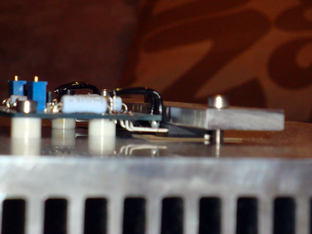

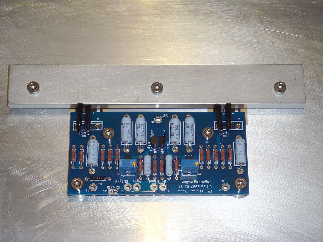

thermistor placement?
just wanted to get a concensus on where the thermistors should be placed. the way i have my board and mosfets attached to the heatsink give me two options. hopefully my photos can aid in determining what i'm talking about. it's hard to get a clear photo that is large enough!
the options are:
1. thermistor is in contact w/ the mosfet and 2 of its pins. it also touches the strip of aluminum i am using to clamp the mosfets to the heatsink. it seems to be electrically isolated still, but touches several pieces and is kind of wedged in there. no pressure is on it, but it's a snug fit (but still loose enough to slide in there easily). i have the leads covered with insulating sleeves. this is how i currently have things set up.
2. i could also position the thermistors "above" the circuit board and they could sit next to the aluminum clamping strip. my concern with this is that they won't be in direct line of the mosfet package and the aluminum strip might provide some thermal shielding so the thermistor doesn't have a good idea of what's going on.
any ideas?

i got it now. those heatsink aren't going anywhere. i know my heatsinks will need to be reinforced.
