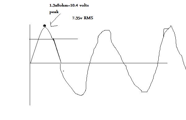

Hi. I remember that P(RMS)=(V(RMS) )^2 /R makes 54/8 =6.75 watt class A RMS power when applying sinusoidal signal(when bias is 1.3A )the peak of signal( pure class A) is about 10.3 volts and RMS of it is about 7.35 volts. Am i wrong?

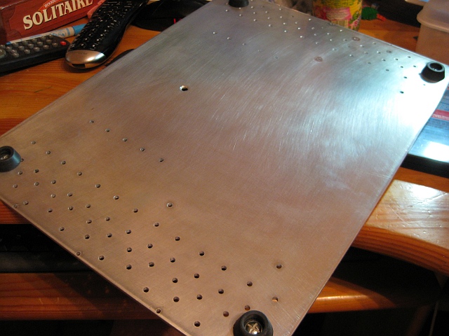

Dear osscar,The bottom plate is almost ready...with ventilation holes.
are you sure your housing is enough airy?
To me, the road from hell to outwards should be as wide as possible...
Am i wrong?
Yes you are.
V(RMS)^2 is not 54
pls read carrefully
OK, one more time, extensively:
Vout (peak) for Nelson's standard edition F5 is roughly 20V
That makes 14.18V RMS
14.18V squared is 201.2
201.2 divided by 8 (speaker impedance) is 25W (RMS)
The point is that you get RMS value by dividing with 1.41 (square root of 2) - or by multiplying by 0.707.
Dividing peak value by 2 gives you average value (for sinusoidal signal), not RMS.

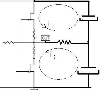

Ok but I did not understand that why we are X2 the bias. P channel has positive output and n channel transistor has negative output.I calculate them seperately.and on positive side it is 10 volts Peak(in class a mode)and it makes 7 volts RMS voltage.Can someone show it in a picture ?
sinewave Pavg = Vpk^2/R/2 = Vrms^2/R = Ipk^2*R /2 = Irms*R = Ipk*Vpk/2 = Irms*Vrms.
we have variables of P, R, Irms, Ipk, Vrms, Vpk, R. Choose the formula that has just one unknown and solve for the unknown.
In the F5 we know bias current (Ib), Ipk=2*Ib, we know the load (R).
we want Power, that is the unknown. Choose P=Ipk^2*R/2 = 2.6^2*8/2=27.04W of average power when the signal is a sinewave.
current bias maximum minimum
Upper half: 1.3 . 2.6 A . 0 A
Lower half: 1.3 . 0 A . 2.6 A
and the difference between the upper half and lower half currents at any instantaneous moment must flow through the load and the NFB if any.
If the upper and lower currents are 1.3A then the difference is zero Amperes and nothing flows to the load and nothing flows through the NFB.
If the upper current drops to 1A and the lower current increases to 1.6A, the difference (-0.6A) must flow from the load and from the NFB to the lower supply rail.
similarly if the decrease and increase were 1.2A then the upper would pass 0.1A and the lower would pass 2.5A and the load +NFB would pass 2.4Apk at that moment.
Note, here we have a ClassA amplifier operating in ClassA and the supply currents are changing from 0.1A to 2.5A. The supply rail currents are NOT constant, despite what many wrongly assume/state.
