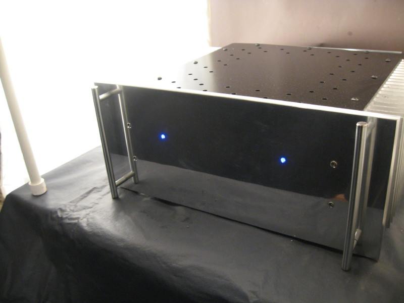

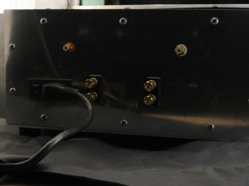

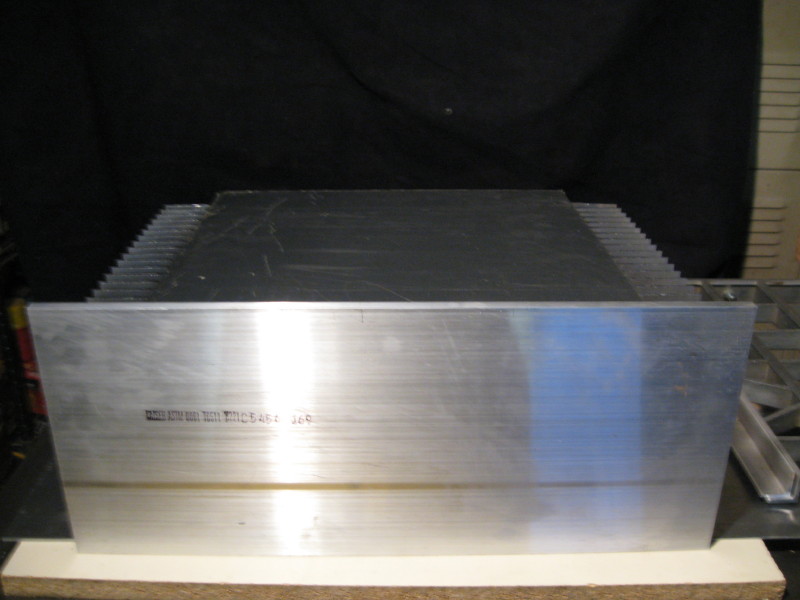

Thanks for the reply. The palm sander must have been dirty work. I hand wet sanded which was dust free. But like I said, it was along process. I was very pleased with the results though. I mayr try your technique this time. What's the highest grit you used on the palm sander?
Steve
Hey Steve,
The polishing process is as follows: Wet sand with 1/4 sheet palm sander-220,320,400,600,800,1000,1500,2000. Buff with rotary 6" car buffer (low speed) No. 7 rubbing compound, Turtle Wax`Polishing Compound for final buff.
Even with an aluminum panel with deep mill marks this process is not that daunting. I only sanded with each grit for a couple of minutes, using different directions. There are better metal polishing compounds but I used what I had on hand.

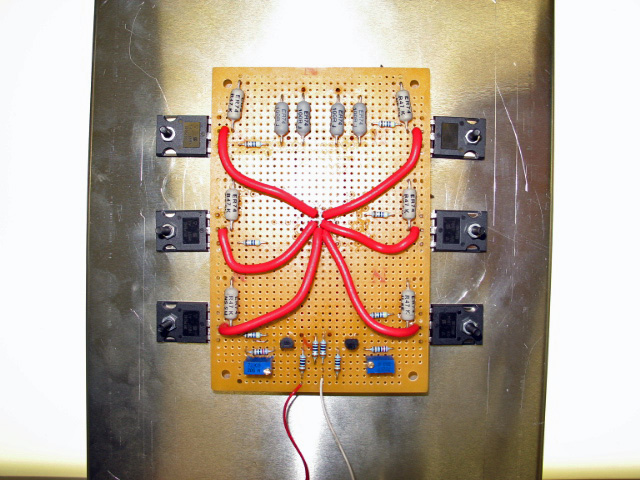

I am using the same voltage but have increased the bias current for higher class A output into 4 Ohms.
I did test it though up to +/- 30 Volt rails with no issues what so ever. In fact it seemed to perform slightly better (not significantly) at higher voltage.

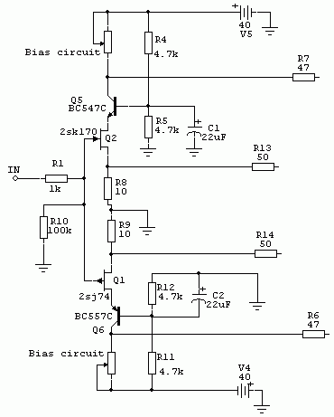

Hello Thanh
I find your amplifier , if I see it well U use 3pair IR power mosfet not Renesans or Toshiba devices .
If you can drive the 3pair IR devices so can I my Toshiba's .
Also I took your advise and made another layout(before I found your amp) I was a bit worried to drive 3pair mosfet with those litle JETs .
Now I have a question if I use cascode (only I ask these because your sim. tests much better if cascoded ) what would be the resistor value at 24V power supp.
Juma made the drawing in cascode mode at 40V rail and his resistor advise was 4.7k . I think 4.7k to high for 24V rail .

the pair of 4k7 divide the supply volts in half. Well not quite half due to the small base current going to/from the cascode BJT.
The impedance seen at the emitter of the cascode is little affected by small changes in the base voltage dividing resistors.
You may want to consider using V grade jFETs to give more current capability to drive the load capacitance and the lower Gm of the Laterals. This may require the cascode voltage to be altered to bring the Vgrade temp back down to acceptable levels.
....You may want to consider using V grade jFETs to give more current capability to drive the load capacitance and the lower Gm of the Laterals. This may require the cascode voltage to be altered to bring the Vgrade temp back down to acceptable levels.
Exactly! V grade JFETS are better solution here and resistors in voltage divider should be something like 4k7 from base to rail and 2k7 from base to ground.
Thanks Andrew
The 4k7 was calculated if I use 40V rail . My question if I decrease the rail voltage to 24VDC what should be the right resistor value .
I think in that case the 4k7 it would be a bit to high .
Can you help with these please . Somewhere around 2k4-2k7 or so would be the right value but that need to be calculated I think .
How you wrote need a small current (which adjusted by the right value resistor )

Hello
I hate to give up!!!! Especially when I have most of the parts (power MOSFETs , transformer , heat sink etc.
Juma you suggest to use for cascode JET not BJT?
Please explain it me a bit .
I know these amp how I design to build it it would work with out cascode . But if I cascode better , easier to drive the 3 pat Toshiba mosfet .
Can you draw it done it would be easier to understand !
Please if you have time . Million thanks for it .
Greets
Hello
Now I understand what did you advise Andrew ! I did look up what a heck is that V Fet .
I would like to stick with the 2SK170 / 2SJ74 JETs orig design I just want to cascode it how you advised & and made your drawing JUMA .
There are working amp 1pair JET drive even 3 pair IR mosfet , but if I cascode it that would help the JET .
Even the sim test better if is cascoded .Of course I would like to cascode for safety purpose .
Otherwise I will have to build it with out cascode , but I can not give up .
