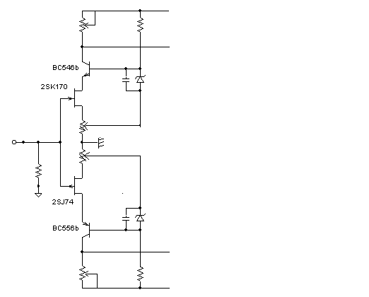

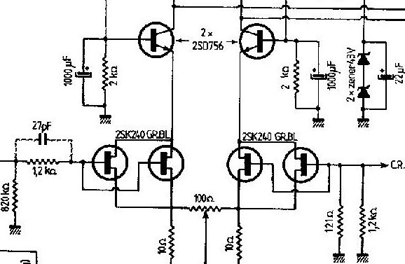

I could post a Jean Hiraga solution for your 6-pair F5X right away, but that would somehow spoil the fun. :clown:

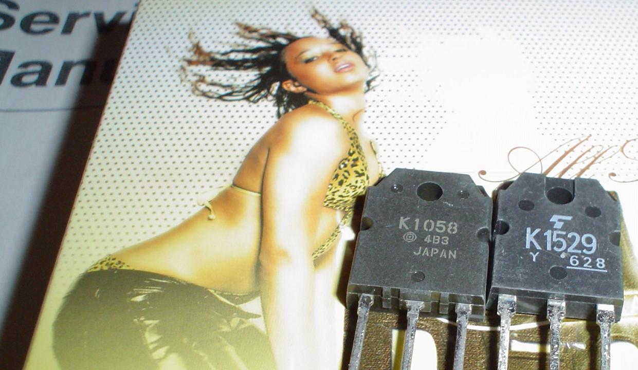

And it indeed was suggested that the easier driven Toshibas would be a good choise
And now we know it only concerns certain samples
I remember when looking at J201/K1530, it was clear that the available Y-version had twice the Vgs than other version, which made mw think twice
Finding the J162/K1058 with 0.5/0.8 Vgs meeting the criteria much better, made me take the chance with this
Or else I dont think I would have
