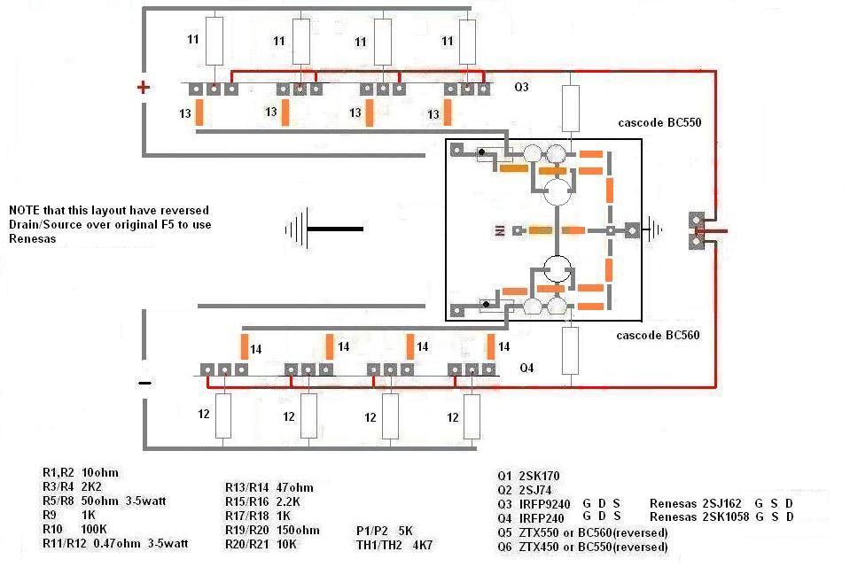

Now you remind, I remember Nelson suggested that
Could it look something like this
btw, some show a zener diode instead of resistor, I dont know why?
A word of caution
The Renesas have reversed Drain/Source over the IR devices, thus the Renesas doesnt fit into the F5 boards from PeterDaniel and Cviller
Its written on my layout to avoid confusion
Hope I got this right

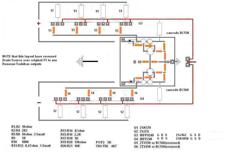

Tinitus
I would like to warn you about the Toshiba mosfet the pin out is the same as the IR devices .
Please check the data .
Probably someone use your drawing for layout and will end up with a bad PC board or can blow up the power mosfets if he use Toshiba devices .
Greets

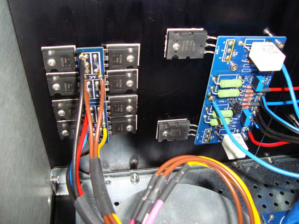

To be sure I'm 100% right I checked again .And yes the Toshiba devices pin out not the same as the Renesans !
Please take a look at Smyslow populated (working) PC board .
He use Cviller PC board with Toshiba mosfet .
If U use Toshiba MOSFETs make sure your drawing is OK . I just read you wrote on your attachment the drawing for Renesans & Toshiba devices .
Please do not take it as a criticism !
Greets
Ex-Moderator R.I.P.
Joined 2005
Ok
If you read my previous post again you will see that I clearly referred to Renesas only, and didnt mention Toshiba at all
Apart from that, pinout on J162/K1058 is exactly the same whether they are Toshiba or Renesas
So nothing wrong in mentioning Toshiba
And I believe they are only available in the form of Renesas devices
Renesas are often referred to as Renesas/Toshiba, but to be 100% safe I have removed any mention of Toshiba
Please also note that theres no component identification on my "board-layout"
Its intentional, because its not verified to work, yet

OK you right !
I read still on your previous attachment Renesans/Toshibas
But I don't care , I check the data .
You wrong about the Renesans , they only produce the ex Hitachi devices .
Please look up the data .
Any way I do not want to argue over these .Not my cup of tea .
I'd rather make friends and learn from them ! That is more important .
The second attachment is OK , I just mentioned because some people does not read well English . Probably they see RENESANS /TOSHIBA and can make a mistake .
Please do not take it as I want to criticize you , not at all!!! Seriously.
Please take a look at cvillier board with the Toshiba mosfet.
Greets
Ex-Moderator R.I.P.
Joined 2005
OK you right !
Ok, I really messed it up
But I clearly write 2SJ162/2SK1058
But you are right
I dont know why I thought Renesas was made on a Toshiba patent, which clearly is a Hitachi patent, and stands in BIG letters
How I could be so confused I dont know, sorry about that
Which means I should proably not be doing stuff like this
Thanks for the correction

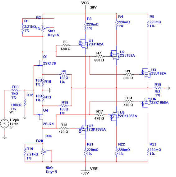

Ex-Moderator R.I.P.
Joined 2005
btw, where did this schematic come from
Is it just a theoretical marriage of F5 and GrandProfet
Or is it a tested proven one, or simulated, or
The difference on gate resistor, 680R on J162 and 470R on K1058, indicates something have been considered
Hmm, yeah, my J162 do have lower Vgs than K1058, is that it
And higher value of gate ressitor relates to its low Vgs, and ease of drive
But IR device seems to have lower on-resistance, I dont get it with these Vgs/Vds figures
Man, I have learned to say "gate-resistor" :clown:
