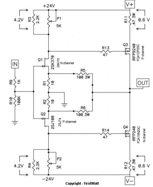

I have finished to mount the board on the heatsink. I don't use part for the current limiting circuit and the thermistor. Now I have a problem, when biasing I got 4.3 v acros r11 and r12, turning the trim pot don't affect the voltage (is was set a minimum). Any idea what's wrong ?
The minimized circuit should look like in attached schematic; when all parts are placed properly, it should run fine.

There's no need for additional balanced layout, just run one amp channel with positive phase and the other channel with negative phase of balanced signal as explained here (page 7): http://firstwatt.com/pdf/prod_f4_man.pdf
Power supply ground should be connected with Chassis/Earth ground through thermistor as per F4 PS schematic (page 15): http://www.firstwatt.com/downloads/f4_om.pdf
Power supply ground is your main output ground reference and that's why it's tapped off the PS.
On the amp board you will only see input signal ground with two pads: one to connect ground from RCA socket, the other for a wire to PS ground (reference).

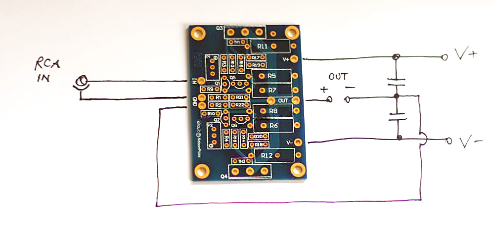

Peter, here's a Jim-Dandy dumb question, but the 2 caps shown here (on your drawing) are the power supply caps, right? ( on your boards ) Making sure there arent two caps I missed somewhere... The ground point between them is the star earth gound? Just making sure before fire up.
I suppose the "jumper" between the power supply board's grounds go to this star as well?

The caps shown in a drawing are on the power supply pcb. The connection between the caps is the power star ground. There is only one wire from amp pcb to that power star ground. The ground from RCA is a signal ground and it connects directly to amp pcb. The power star ground is located on PS board (if you are using one).
Thank-you Peter, I thought that was how it hooked up, just wanted to make absolutely certain before calling it done. Thanks!
