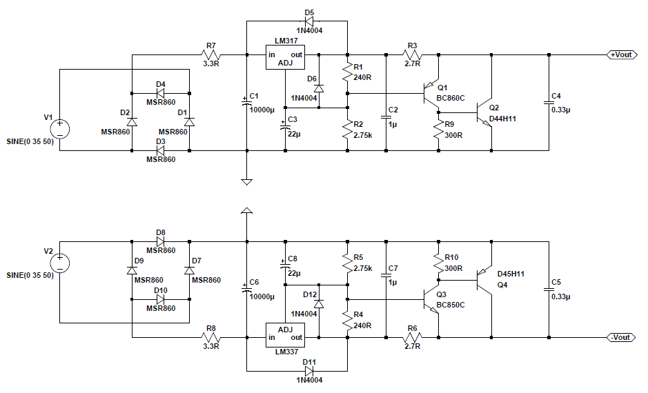

> I very much appreciate you posting the spice files and making it easy to play with the designs.
Pleasure.
In addition to playing with Spice, you should also study the datasheets thoroughly.
For example, it tells you that if you use a low ESR cap such as mylar for C7 in post #85, you are likely to get oscillations.
Spice helps you to understand parameters and components in circuits.
It is still not all reality.
In the end you have to build something.
And then measure, then listen.
Patrick

Note that this is for a cap multiplier or 7815/7915 type regulators, and 150mA bias.
You will need 35VA 2x18Vac for the Nazar reg because of extra voltage drop across R7 & R3, in case of +/-15V rails and 150mA bias.
Alternatively, 30VA 2x15Vac would be sufficient for +/-12V rails. You need to change R2 & R5 accordingly to lower the voltage.
Also I discovered a small typo in post #81. Sorry for that.
The values are for a bias of 120mA, and total current draw is 240mA.
For 150mA bias (300mA total current), change R3/R6 to 2R.
Patrick

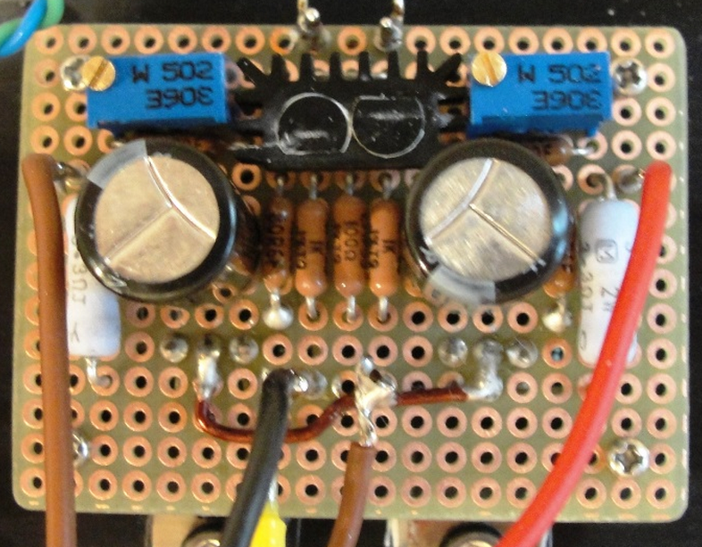

What value are the 2 electrolytic caps on your boards pictured below?
I assume they are for power supply filtering?
I didn't see them shown in the schematic from post 5.
From your other photo they appear to be 25V Panasonic FR-series caps.
Thanks...
