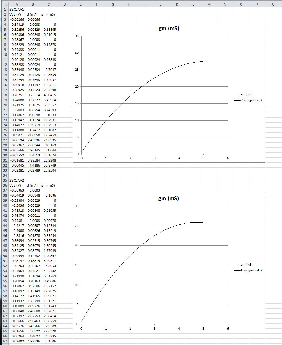

I ordered a few pairs from this seller after reading this, received them today. Measured 2 of the 170GR and they look very genuine to me

Patrick, My JFETs Just arrived this morning from 'alweit'.
The two closest pairs Idss values are 7.81 for one pair and 7.82 for the other pair.
For 7.8mA Idss, you can use the drain resistor values as is (820R // 5k trimmer).
