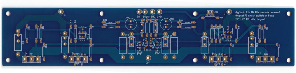

I have spent hours comparing the technical specs and prices of components for my F5 project. I have attached a copy of my bill of materials to this post which maybe of interest to others who are starting out like I am.
Can I ask for members views on PSU caps? On the RS components site I have the choice of a Vishay 101 PHR, 15,000uf cap or a BHC ALS30, the BHC has a higher ripple and leakage current than the Vishay and a longer life. Both similar prices. Based on the datasheets which one should I go for?

how about using a panel mount pot in front or back of the chassis? for easy adjustment
those things are copyrighted by Mighty ZM - as Pot for Amount of Zen
You'd still need a way to measure voltage across the resistors, in order to set bias. For measuring dc offset you could still use the output binding posts. Maybe you can use 4 extra binding posts to that end. Per channel that is.how about using a panel mount pot in front or back of the chassis? for easy adjustment
P3 has nothing to do with bias or DC offset
I'm sorry, I thought you were talking about P1 and P2.P3 has nothing to do with bias or DC offset
Just yesterday I had to re-bias my F5 for the summer period. Heatsink temperature was around 70 Cº !! I had to bias it to around .350mV on each resistor (instead of the "default" 0.600mV) in order to keep the heatsinks below 60 ºC. Madrid's peak temperatures may easily reach 40ºC

C9 is not polystyrene, but a polypropylene radio frequency suppression cap, Y2 safety rating.
The pot P3 idea is nice... Especially if there is no space for it on the board.
Otherwise, the Bourns 3296P should be nice too. Depending on how you mount the boards though...
By the way, if heat is not a problem, what is considered the max bias that the 3W stock components can handle?
