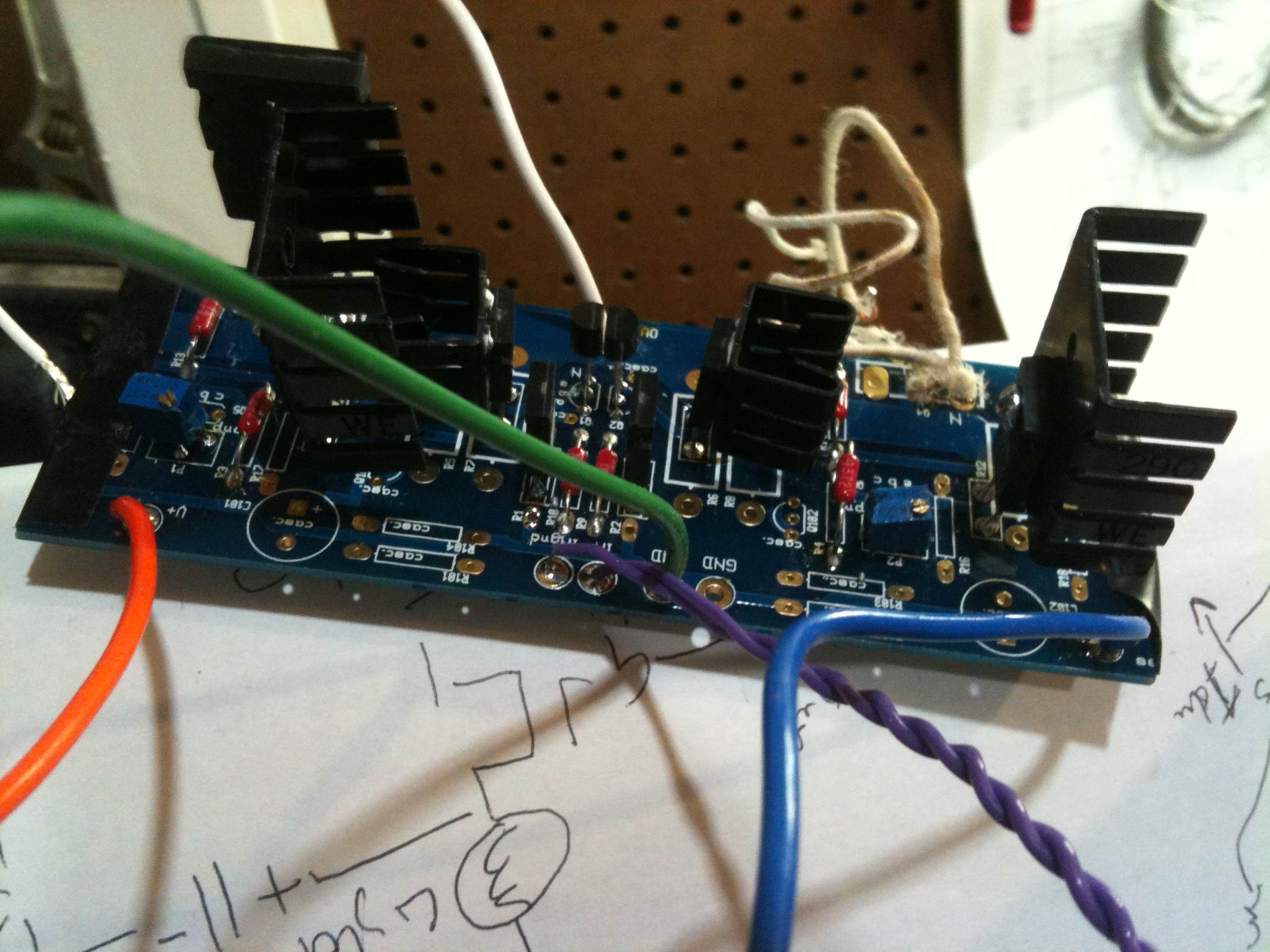

This is my reference F5 amp , for now.
This is a no thermal compensation, no current limited design, with Toshiba outputs. The resistor compliment is now (from PRP in pic) 1k texas instruments z-foils, 47r z-foils 100K caddock TSF, 1K prp resistor in parallel with 5K pot for setting bias.
The source jfet resistors are 10R caddocks, 50R caddocks for feedback resistors and Mp-930 .5R source resistors for toshibas.
The board is a cviller version 2 board, hacksawed down to fit into smaller chassis. Run ~.750mv bias.
