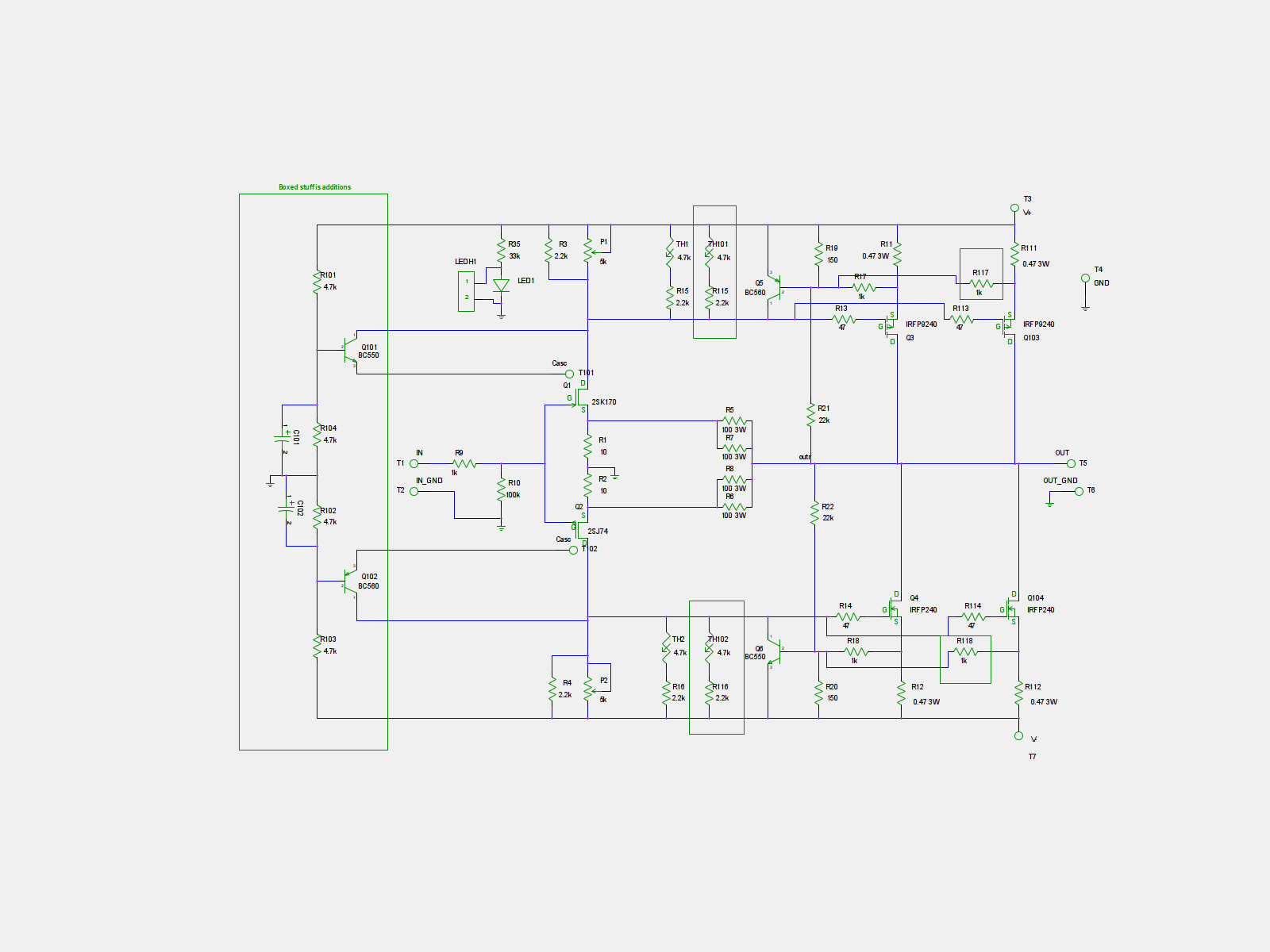

I'm going to add parallel output devices. Cviller's (attached) has a 1K resistor (R117 and R118) on his cascode schematic that you do not have in yours. It there a correct way to add more outputs?
there are at least 4 cascoded F5 schematic posted , all of them pretty much similar .....
dunno - I think that AR2 even tried this one
I didn't , but I can't see why it shouldn't work

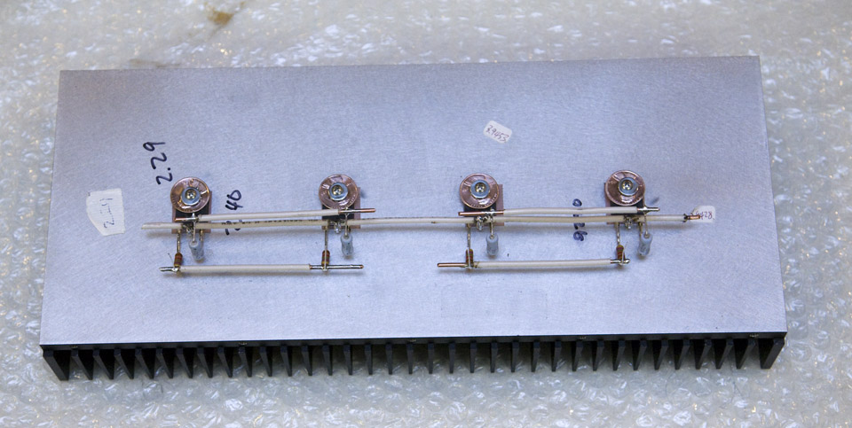

I set up for parallel outputs on my heat-sink tonight. I haven't had a chance to try it out. Tomorrow I'll see where I can get to with bias. I'm ordering new insulators, but they'll take time to come.
I could use advice on a few fronts:
