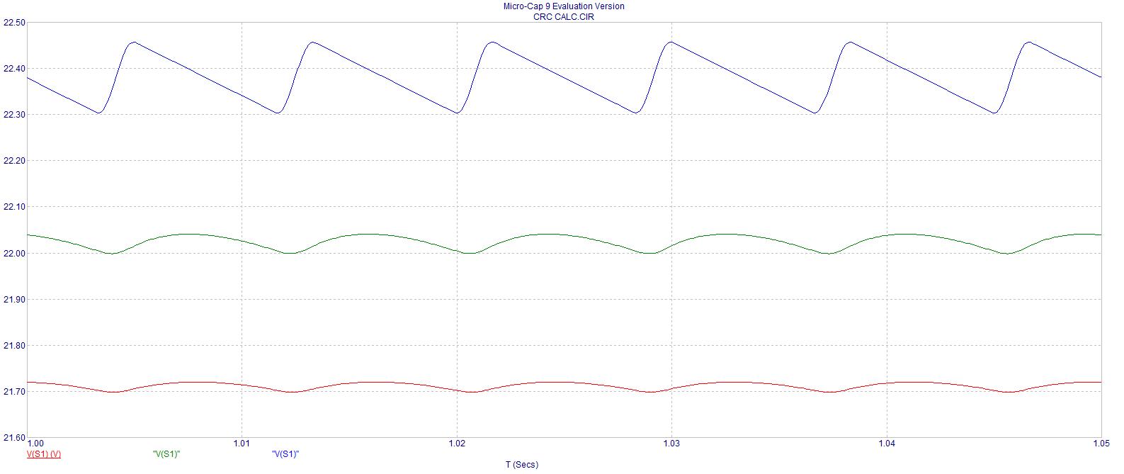

My questions are:
  1. Can one use the resistor in the CRC filter to make the output voltage land where you want it? The thread suggested 16V rails. Can I "get" the rails to 16V by variying my R until the desired voltage is reached?
  2. The Antek 5415 has four outputs, I only need two. Do I just use two and leave two unconnected, or do I tie two in parallel (twice, to form two outputs from the four)?
  3. With inrush current, NP ultimately suggested CL-60 or CL-30s. I was worried about the steady state current and the resistor value of the NTC. I wanted to know if Ametherm's SL22 10008 was ideal (Ametherm SL22 10008 ---10 ohm / 8 Amp Inrush Current Limiter Data Sheet). It's 10R0 and has a steady state current rating of 8A. It can handle 90J, it it too robust?
  4. Finally, how big a C does one need in the CRC filter? I saw 20000uf for each C suggested at one point, but it seemed low to me.
Honestly, If I could clear up those questions, I could build tomorrow.

I am not ZM. But I thought I would give you my take on your questions.
First read http://firstwatt.com/pdf/art_power_supplies.pdf
Second, Download PSUD2.
Yes. There may be better ways if the difference is more than a few volts.
Either will work. I would parallel 2 for lower IR losses in the transformer.
Bigger has more turn on surge. I would look at PSUD2 and balance ripple, turn on surge, Q (look at what happens when the power supply changes current demands.)
HTH
Doug

Its not a good idea to use resistors in the supply to drop voltage because they will either catch fire, or at least will be burning a lot of heat. It may be fine in preamps, but not in a class A power amp where you have a large constant current draw. If 16 V rails are suggested and you are getting 18V, I don't think it should matter much. NP has said many times that all voltages in schematics are approximate.
The power dissipation is 'I' squared 'R'. Measure the voltage drop across the resistor, divide by the ohms of the resistor and that gives you the current through the resistor. Square the current and multiply by R and this gives you the power that must be dissipated in the resistor.
If you're passing 2 amps through a 0.5 ohm resistor, the dissipation is 2x2x0.5 = 2 watts. I would recommend atleast a 10 watt resistor for this duty as it is continuous dissipation.
A 'C' of 20,000 uF is freakin huge... obviously you can have bigger caps, but make no mistake, this is a big cap capable of killing you if you're not careful.
If it were me, I'd build the stock F5 first. This is too ambitious for a first project (again, for me).

1. as other members advise you already - don't try to burn more than ,say,500mV at R part in CRC ( or multiple) filter ; reasons - excessive dissipation on resistors , same as unnecessary slowing down entire PSU .
download PSUD from Duncan's , read help - where is explained thoroughly how to determine all things , especially how to include necessary data for xformer - internal impedance etc.
2. use one diode bridge per each secondary , then parallel two and two ;
point is in paralleling after the bridge ; look for principle in Papa's FW PSU ; reasons - no buzz and no current hogging if secondaries aren't identical in smallest amount ; and they're identical only if they're wound multifillar ..... which isn't smartest way for making cheap tororids
ask for help/exact schm if you're unsure in this
I have feeling that you're good with 15Vac secondaries - but your homework is to bring us numbers ;
you can always post *.psud file here ( zip it ) , and I'll (or someone else ) gladly double check for you
3. 10R thermistor is good for 220/240V mains , maybe overkill for you - as you're in States ; use CL60 - it's easy available there , at least to my knowledge
4. I'm using 33mF-0R1-33mF per polarity for Papa's Koan amp ;
more precisely - 800VA Donut , 4x18Vac ; so - per channel : two 18Vac - two bridges - 4 33mF caps , two 0R1 resistors
easiest path for every Greedy Boy - look at Papa's original schm - augment VA & C for your liking , put brain on neutral , enjoy .

While I agree with ra7 here, there are other ways of achieving this.
First you can parrallel four 3W x 2 Ohm resistors.
So that will be 0.5^2 x 2 =0.5W per resistor.
The other option is CRCRC or CRCRCRC etc
Eg 15000uF 15000uF .25Ohm 15000uF 15000uF .25Ohm 15000uF 15000uF
Then you can parrallel four 3W x 1 Ohm resistors.
So now you have 0.5^2 x 1 = 0.25W per resistor.
This is just to show how you could safely go about it. However I wouldn't worry about dropping the voltage if you are in the ball park. This amp will go into class B so there is no worries about dropping the bias a bit to compensate for increased voltage.
ra7
Joined 2009
Yes, this is possible too. As long as you can provide enough margin to cover the dissipation needs, you should be fine.
The point is to not drop volts on the resistor, coz the dissipation starts getting out of hand pretty quickly. I know because I've smoked some resistors myself. If you need to drop a lot of volts, for example, if you're at 25 V and you need 16 V, it is best to use a regulator like in ZV3.

I don't know, I asked about CRC filter equations - I got indirect answers.
I don't think the actual equations are likely to advance the
discussion much, but here's a graphic from an F5 supply
showing the DC and AC voltage seen by the amplifier
channel with three values of resistance in the CRC (the
C's being 30,000 Uf). The upper trace shows no
resistance, the middle trace 0.25 ohms (stock value) and
the bottom trace 0.5 ohms.
As resistance is added, the noise gets lower and there
is greater reduction of high order harmonics in the noise,
but you start to lose rail voltage.
