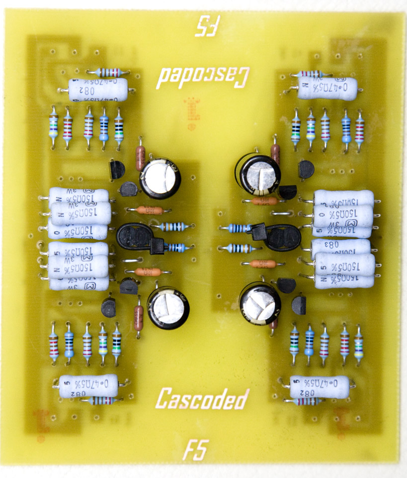

New PCB
I etched a new board with the caps going to ground. I'll start with the IRFP outputs and then switch to the Toshibas. Two output devices per side of the circuit (eight MOSFETs total).

Here are the redesigned, re-etched, rebuilt "Cascoded F5"s (still minus thermistors and Mosfets). These caps reference ground. For the moment, I'm using an equal voltage divider (4.7K ohms, 4.7K ohms) on each side.
I'm moving tomorrow and Tuesday, realistically, I won't have a chance to try this until the weekend at best.
Perhaps others can post their progress until I'm back in action.

Yes, I know. I'm mounting the Mosfets remotely. This board is for testing, when I go for the final version, I expect to have pairs of outputs on each leg of the circuit (8 Mosfets in all). To limit problems, I'll put the source resistors on the legs of the Mosfets as well as relocating the gate resistors. Mounting the PCB to the heatsink has always seemed like a limiting step. I like the idea of exchanging amp boards while leaving the Mosfets mounted and in place.

hey NYCOne
I suppose you are aware that you have 2 channels together on one board, and probably made for balanced
well, in terms of heat, its not good to have both channels share the same heatsink
