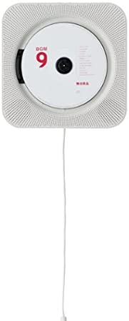

Haha!
This (logical etc.) reminds me of rhis:
(muji wall mounted cd player)
