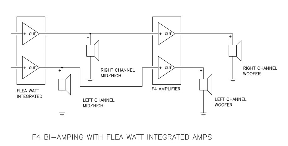

Just as a point of clarification, what I am suggesting is exactly as is shown in Option #2 of the F4 Operation and Service Manual. No active crossover is shown.

this one ?

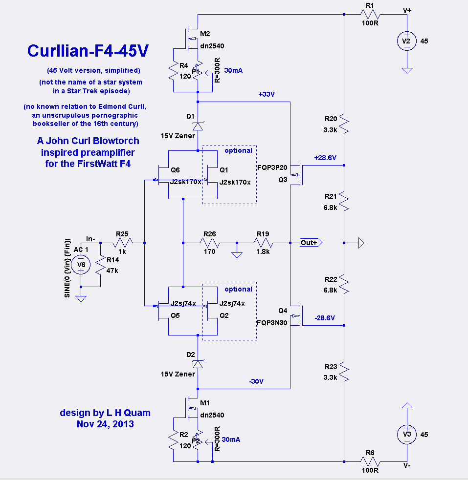

Curllian-F4 update
In post #3842 http://www.diyaudio.com/forums/pass-labs/97540-f4-power-amplifier-385.html#post3684975 I showed a schematic and distortion measurements with power rails at +/-24V and +/-32V I was somewhat disappointed with the distortion at higher frequencies so I built low amperage power supplies increasing the rail voltages to +/-45V (I can go higher, but that would require heatsinks for the output MOSFETs).
Below I show the updated schematic and distortion sweeps. The distortion is reduced about by about a factor of 2 vs. the +/-32V measurements. This is largely due to running the MOSFETs at a higher Vds where the Cgd (gate to drain capacitance) is lower and more constant.
The next step to to build a 2nd channel and install these in my F4.

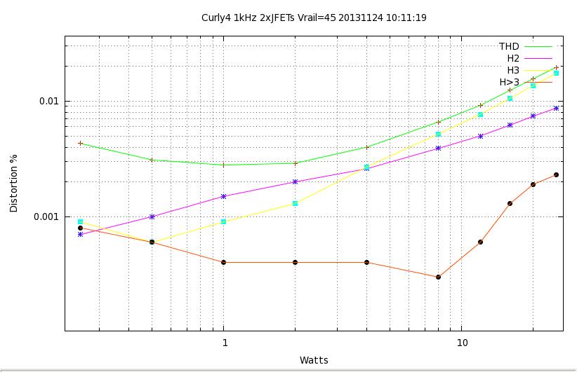

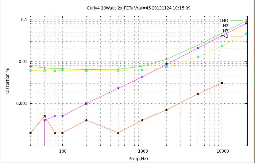

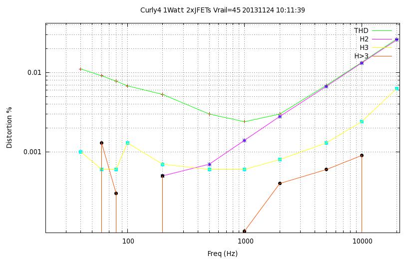

I found a bug in my software that computes THD for the sweep plots. It only affects the THD calculation at low frequencies at levels near the noise floor. The H2, H3, and H>3 plots were correct.

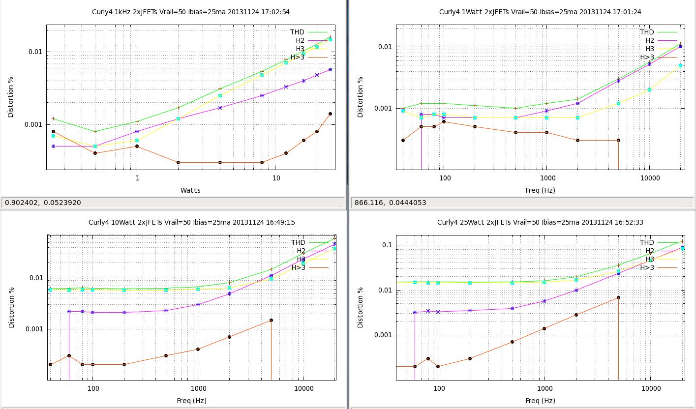

Here are new plots for 50 volt rails and folded cascode current of 20mA plus 5mA for the folded cascode gate voltage divider network.
Wow! These are looking very good. the higher voltages really help.
What does it look like driving a 47k,20k , or 10k load using it as a preamp buffer after a tube ? I know that a little off the subject but that's along the lines of the cj evolution that they charged 20k for .
The measurements were made driving about 6 inches of twisted pair to 3 feet of RCA cable to a 10:1 attenuator driving a sound card having a 10k input impedance. Not counting the capacitive load of the wiring, the preamp sees a load of about 33k. I haven't tried it with a 10k load, but it should be fine, just a bit lower output level unless the 1.8k load resistor (R19) is increased. The folded cascode is a transconductance amplifier. The AC output current is the JFET gate AC input voltage times the sum of the transconductances of the JFETs. The output voltage is the output current times the parallel resistance of R19 and the external load.

lhquam.
  • Suppose that the center point of the voltage divider is not grounded, and thus is at a virtual 0 VDC.
  • Suppose that Vout is then connected to this center point, and its original output load resistor [1.8 K] is not used.
This new connection gives a pathway for AC and DC negative feedback to the MOSFETs. Each MOSFET thus plays a dual role. It operates simultaneously in a common gate [like the parent], and a common source configurations [with feedback]. It may follow that voltage gain is reduced [opposite to your liking to drive F4], THD is further lowered and so is output impedance. DC feedback may enable a DC servo action so as to center and lock the output DC offset at 0 VDC.
