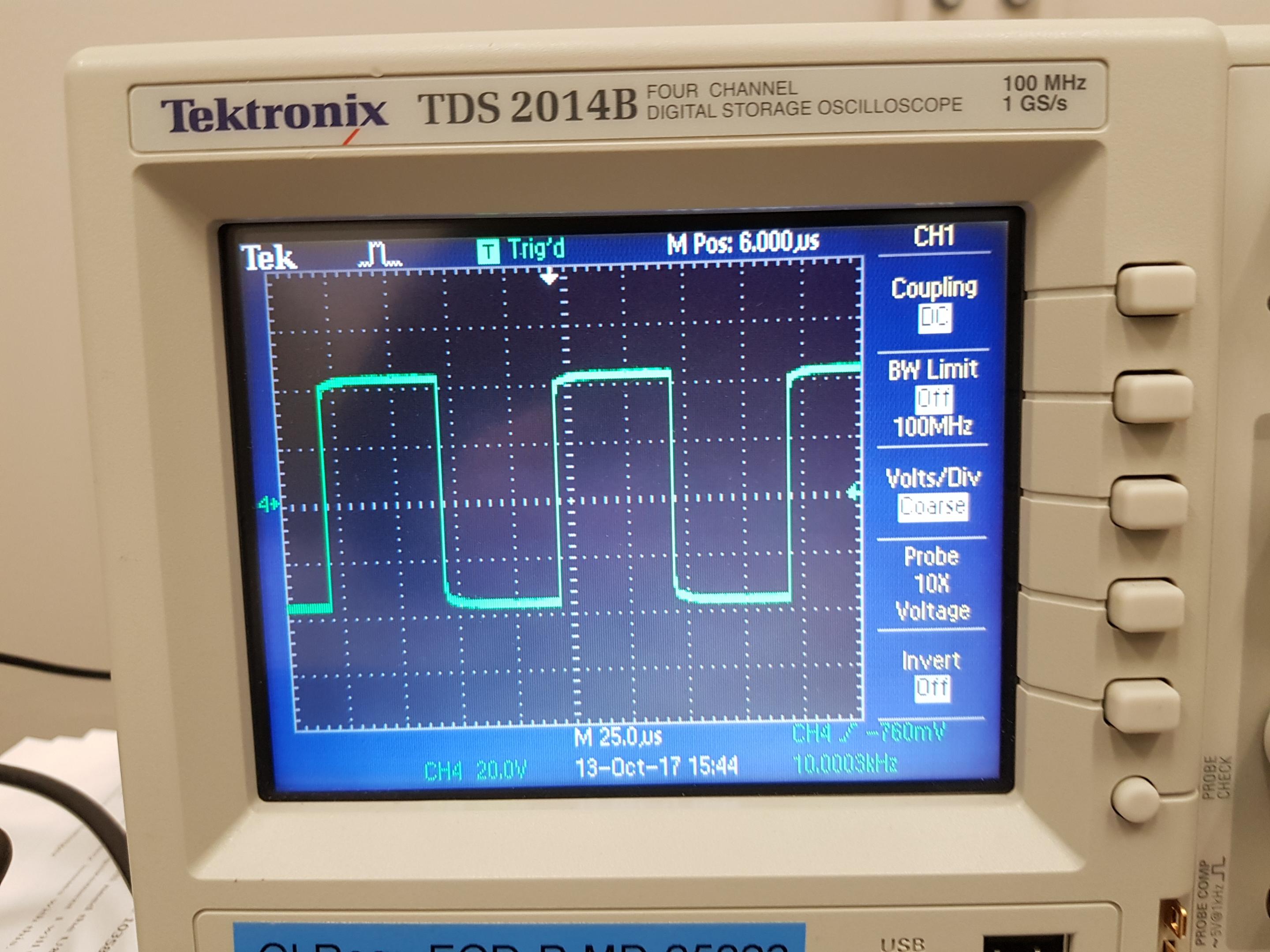

10kHz square wave

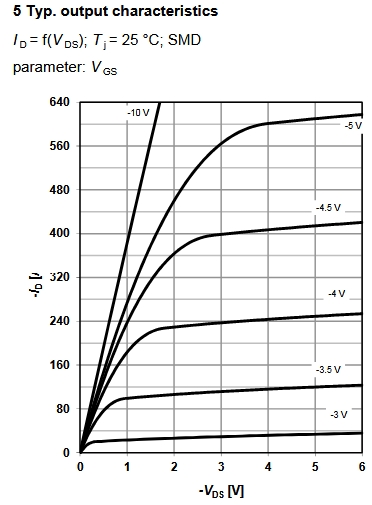

That is the IPB120P04P4L. Its a TO220. I am not certain how good it will be at getting the heat out to the heatsink. They were $2.31 each from Digikey. I bought 10 each of the P and N. If I blow up a few, no big deal.
If you look at the IdVd curve, Vds is 1V at 400A. Thats about 2.5 milliohms RDSon. I cannot find as good of a P part in the hockey puck package.

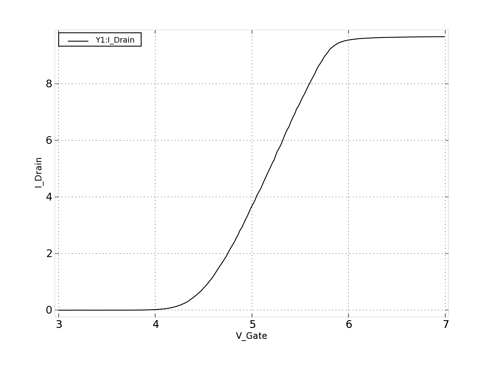

Ids vs Vgs
Today I ran some tests on the IPP120N04S4. Attached is the curve for Ids vs Vgs.
The test rig can only go to 10A and the cables from the rig are ridiculously resistive compared the RDSon of the MOSFET.
I just wanted to see where the bias wants to be to get a good running start at the linear portion of the curve. Looks like between 1.5A and 2A bias.
I am currently gathering heatsinks and parts to throw together a prototype.
Please be aware that Vds-Id measurement should be done at constant temperature. The curve is temperature dependent.
I agree. I have used two approaches:
  1. Vgs ramp at a sufficiently high frequency, such as 200Hz, that temperature effects are minimal. This requires a way to capture Idrain, such as measuring the voltage across a sense resistor.
  2. Low duty cycle Vgs pulses of varying pulse height, with the "nominal" level to maintain the desired operating temperature of the FET.
In my implementations, I use a Rigol DG1022 programmable waveform generator and a Rigol DS1054Z digital sampling scope. The measurements from the two approaches agree quite well.
