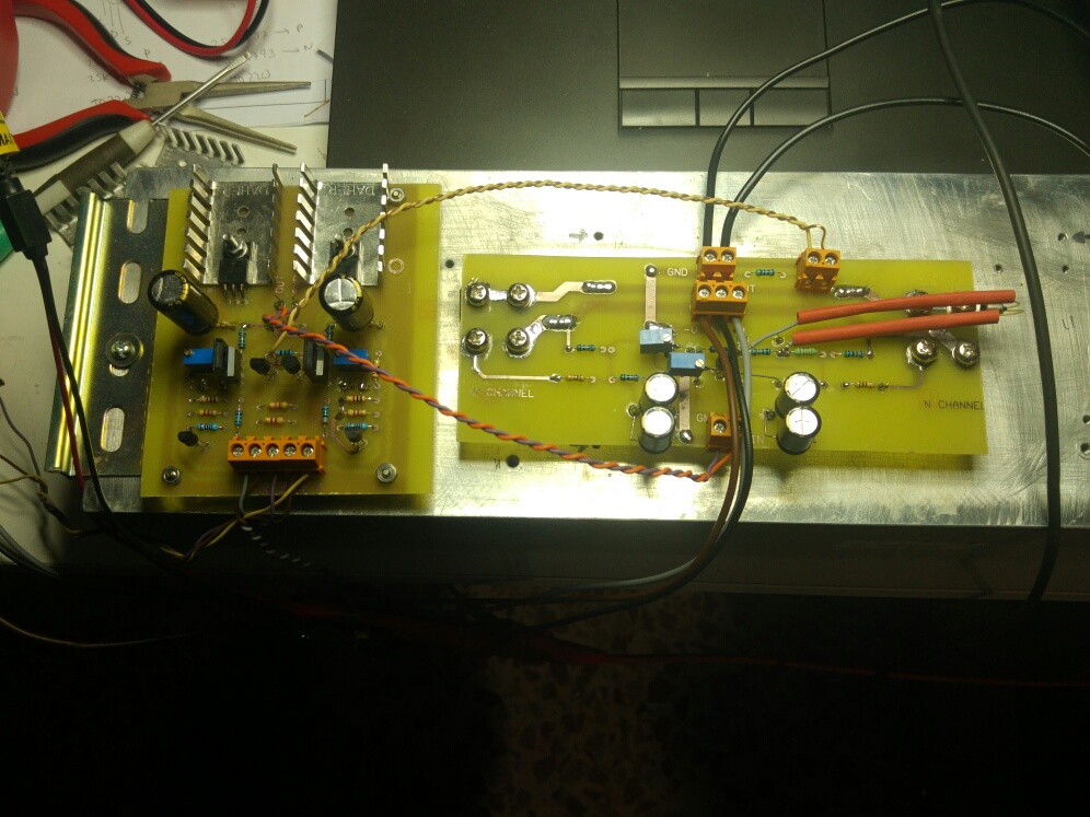

Juan from Spain is just too building an F4 beast and he used one of "my" circuits. And he run into some problems due to my not full description what I did.

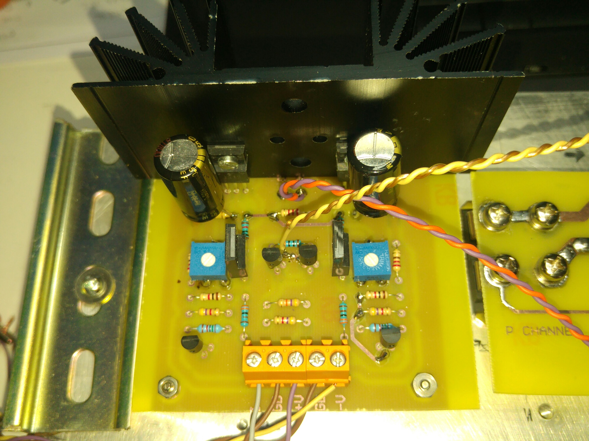

Hi all. This is a very nice project. Thanks a lot Gerd. Error was mine for do not look that detail of your schematic. I am using full front end from sony 2 article. It works very well (only I have 20db of gain instead 26db as article said).
I hope have it working very soon...
Thank you all
Juan Antonio

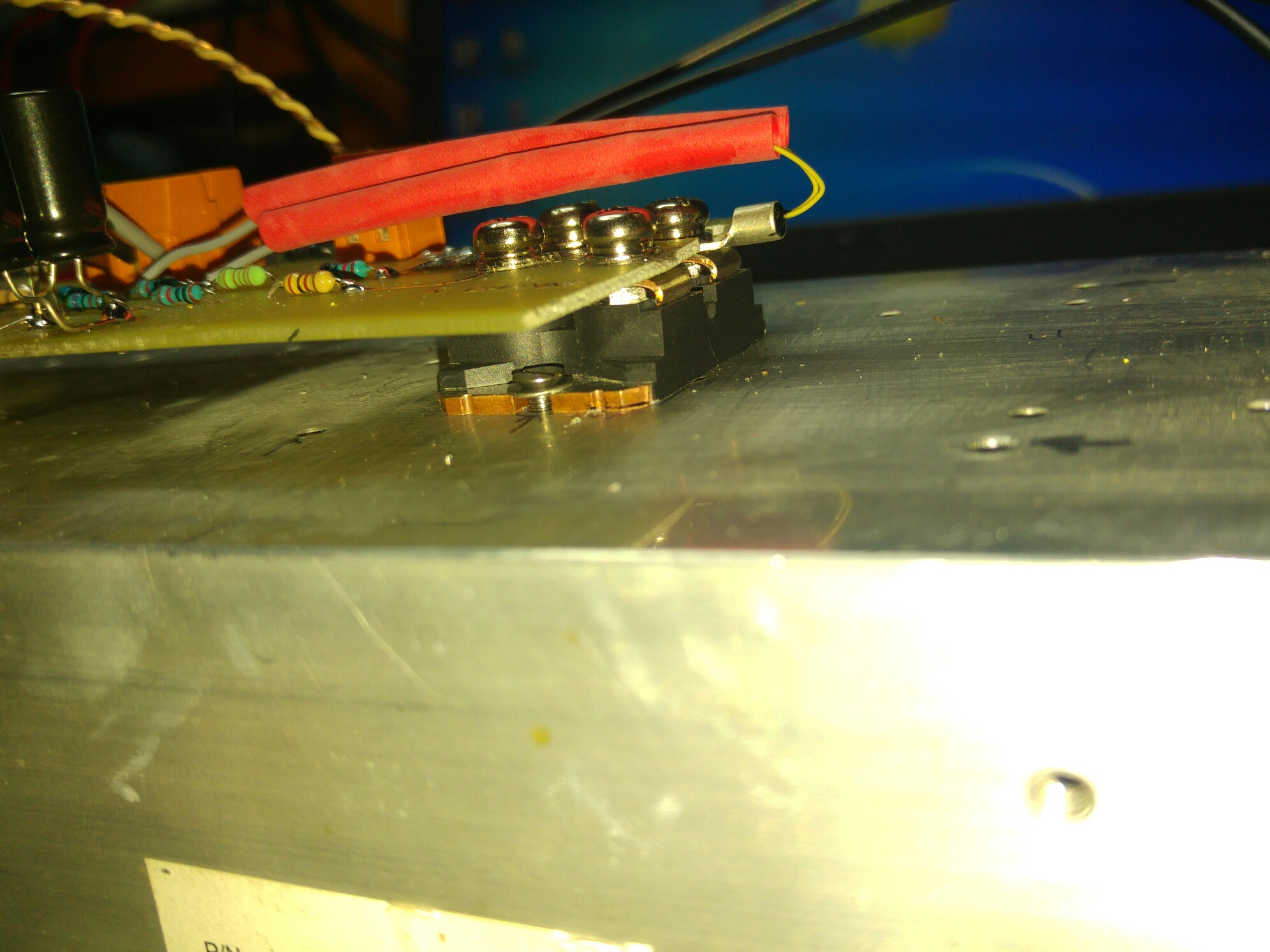

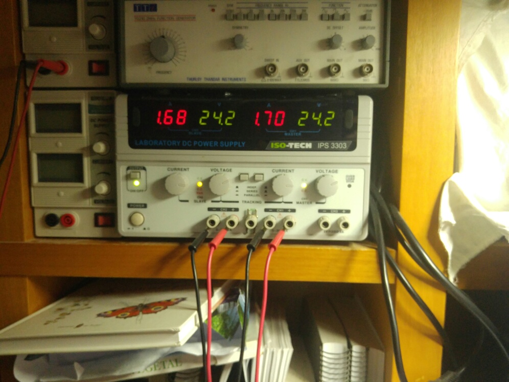

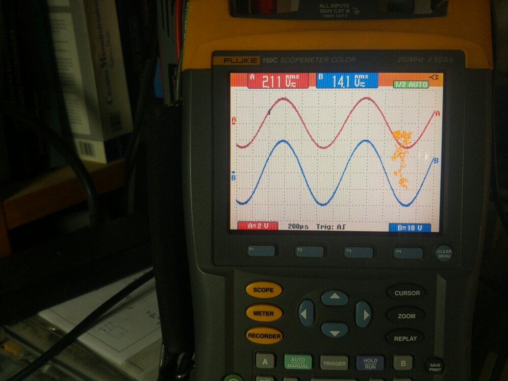

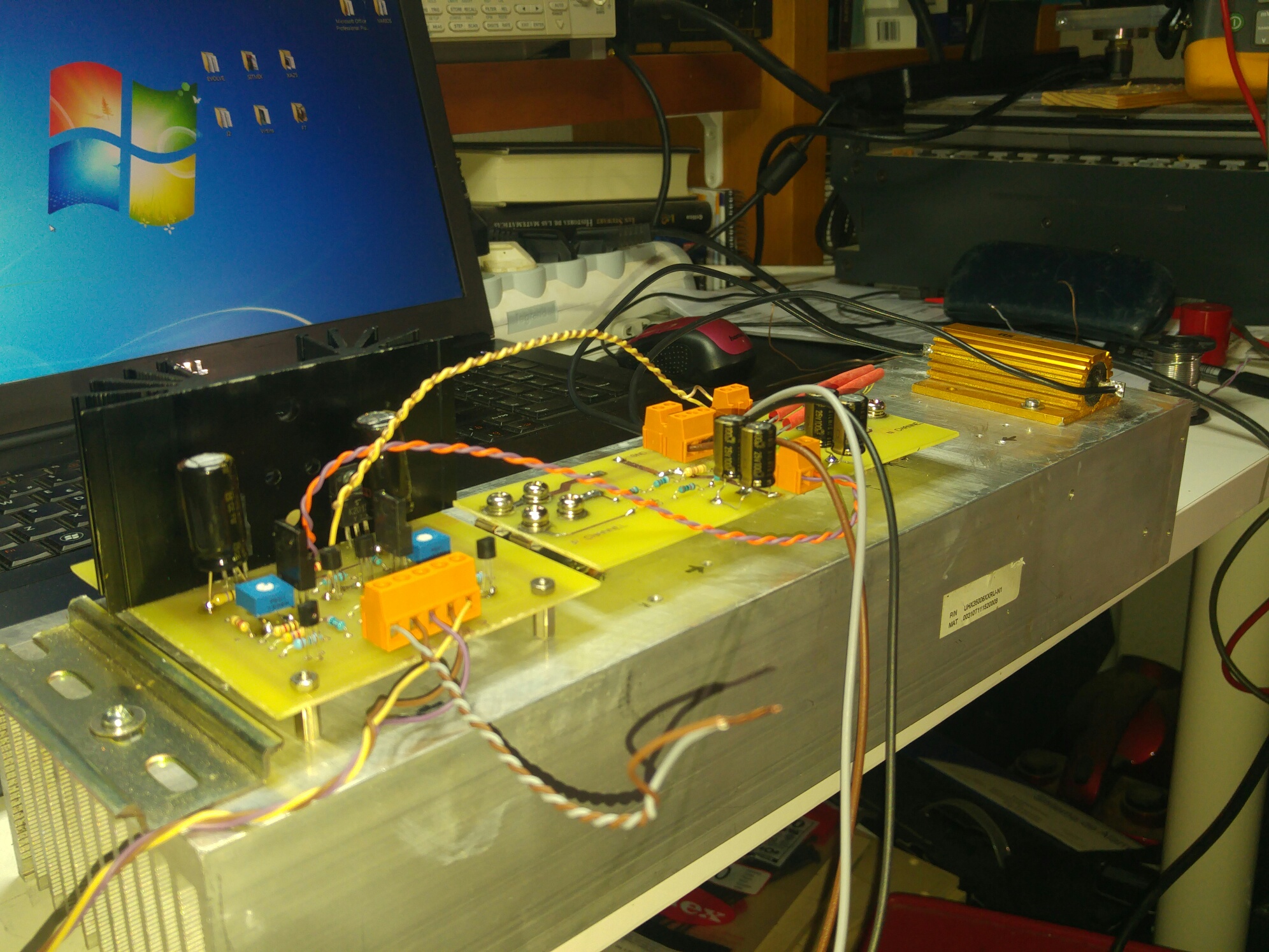

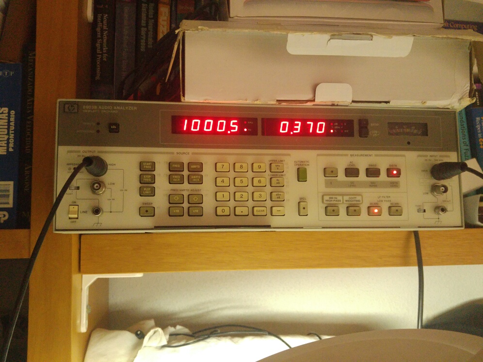

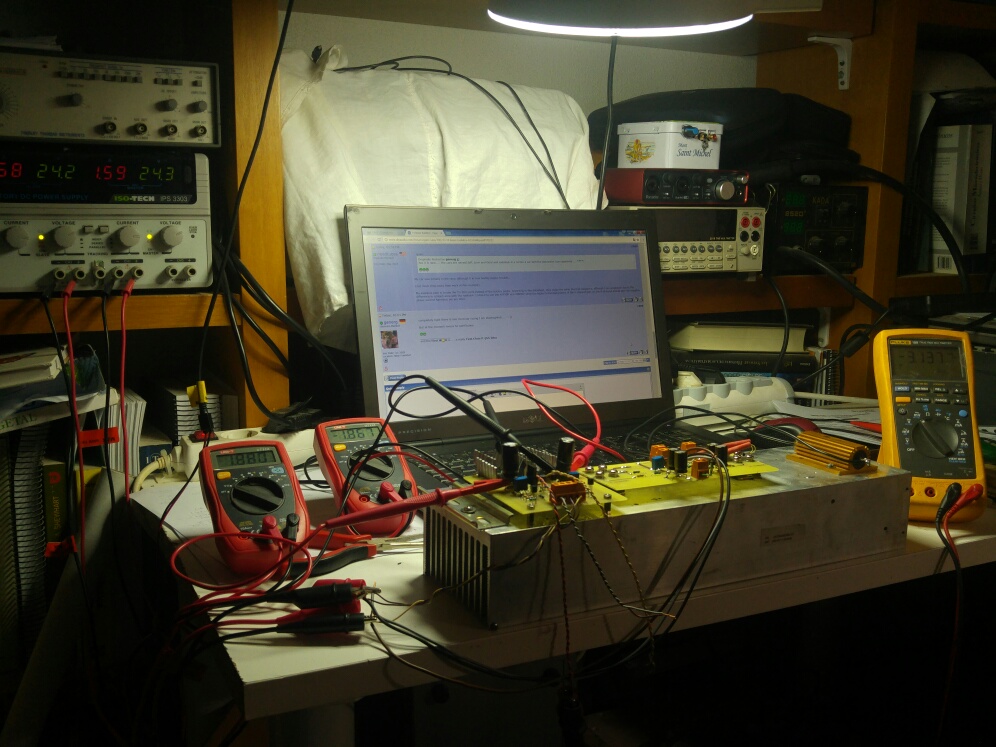

Hi all. I am not in the race.. only contribute something. I have fixed errors and later a few time looking how is thermal derive, I have adjusted for getting around 1.6A, more or less stable, without smoke or flames. It is possible do it. Attached are some photos. But I have not measure harmonics yet. Before this only want to check if works or not (smoke or flames).
I have not get nice numbers you have obtained. Maybe because I only select ixys using vgs (I have not time for using a curve tracer and get transconductance of toshibas or ixys). My distortion level is 0.11% at 1W 8ohm and 0.36% at full power. These numbers are only numbers because I need measure for harmonics set, but not today.
Best Regards all

Thanks for taking the measurements Jama. I'm surprised at the rounding of the leading edge at 20KHz I would have thought the low output impedance of the front end would have negated the high input capacitance of the hockey pucks but obviously not.
