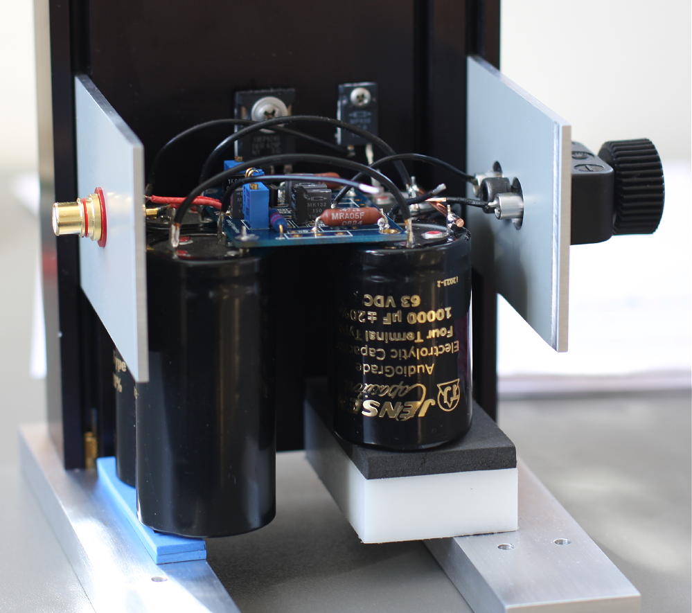

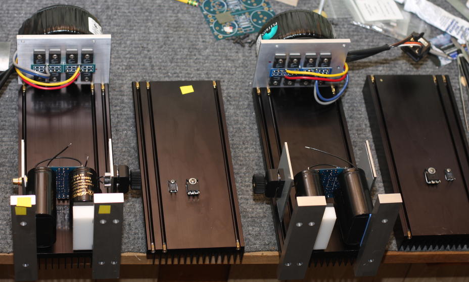

I always like to build my amps slightly different than commonly accepted methods, there were also reasons why the pcb was designed in that particular way.
It is one channel only, the caps in a back were afterthought as I originally planned to have them separately, together with transformer and bridges.
The resistors on PS board are part of passive filtering, I will have them here too, but they will be p2p wired.
I'm not sure if it's worth it: Caddocks MK132 seem to be marginally better than Mills, sort of smoother, but nothing major really. I used 2 x 150R in parallel per side, each one is 0.75W and they run cool. I used them, beacause I had them already on hand and I needed a bit more gain.

Reason for the spacer between outputs
and the main heat sink?
Was this done for ease of packaging or do you think it assists in transferring heat?
I know you placed lengths of aluminum on top of some of the chip amps but I have not noticed you having done this before?
Would you explain?
Are you using mica for insulation?

That is a main heatsink. The size is approx 11x5 and it's one heatsink per output device. I'm using beryllium oxide pads, those are discontinued now but Mouser should have similar product with aluminum oxide: http://www.diyaudio.com/forums/showthread.php?s=&postid=1494970&highlight=#post1494970

rickmcinnis said:and the main heat sink?
