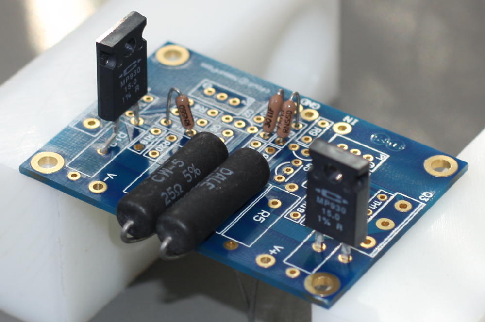

samoloko said:also Is It the only problem with these pcbs the radial power transistor and bending the trim-pots
The radial resistors should fit, as well larger power resistors. The trimpots should have pins in line, but it's very easy to modify.
thx Peter
seeing your pics there are options when choosing big resistors for F5
which Peter do you prefer
