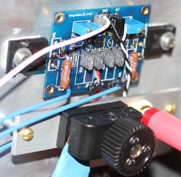

Yesterday I installed Caddocks MK132 in place of Mills feedback resistors. I used 4 x 150R per board, which gives slightly more gain. The sound seems to be less forward and maybe a bit better bass, but nothing really major.

MK132's for feedback
Dear Peter,
Thanks for the link for the thermistors.
Do you think there will be a heating problem with the substitution of 1.5 watt rated resistors versus Mr. Pass's specification of 6 watts?
How do the 75 ohms resistors affect gain?

Diomedian said:
It has previously been noted that the lead spacing of the resistors was 0.2", and that Peter recommended Vishay CFM-50 or Caddock MK132 resistors, both of which have 0.2" lead spacing. The Dales you use there are CFM-55s (or their military equivalent).
-j
I have a stupid question to ask here.
I went around searching for cmf50 and noticed that most of the stock mouser has is only 1/4W or 0.25W whereas MK132 smallest is 0.75W.
appreciate advice what is the minimum requirement as the range is quite big from 0.25W to 0.75W.
