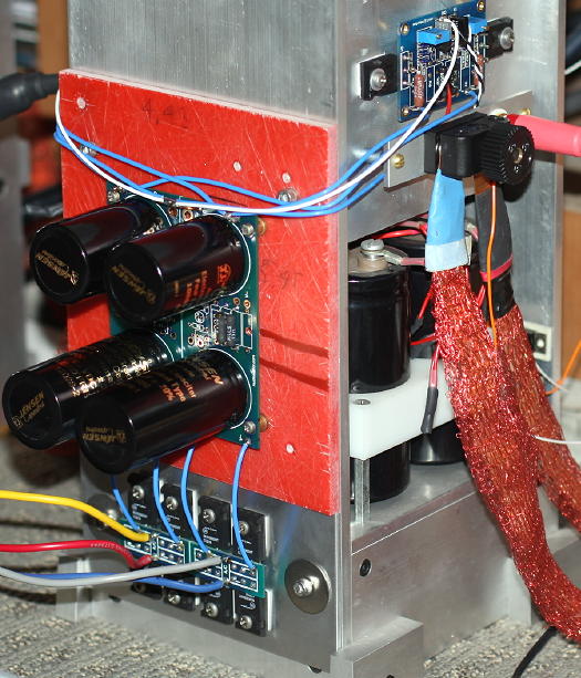

orthoefer said:
I may wait until there is more info on the Jensens before pulling the trigger.
I tried Jensens tonight and they work fine, no heat issues at all.
They sound more relaxed and delicate, almost velvety comparing to Sikorels. I cut the traces on PS board to implement 4 pole feature. A small engraver and a blade works well for that purpose.
I have them with MUR3060 diodes, first cap is 15,000/63, the second 10,000/63, with two Mills 0.22/5W in parallel per side. The resistors are only warm.
While originally the amp sounded bright, I'm not getting that impression any more.
Peter, thanks for doing all your tests and reporting the results. Any reason you selected 15,000 and 10,000 mfd as opposed to 2 15,000 mfd caps? At the moment I am a little floored by the cost of Jensen caps, especially for dual mono aps (8 x $50). Any suggestions for sources of Jensen caps? Thanks.
FWIW, I emailed Jensen and the 15,000 mfd 63V caps are on a 2 week backorder. The price from him is approx 29 euro per piece plus shipping.
