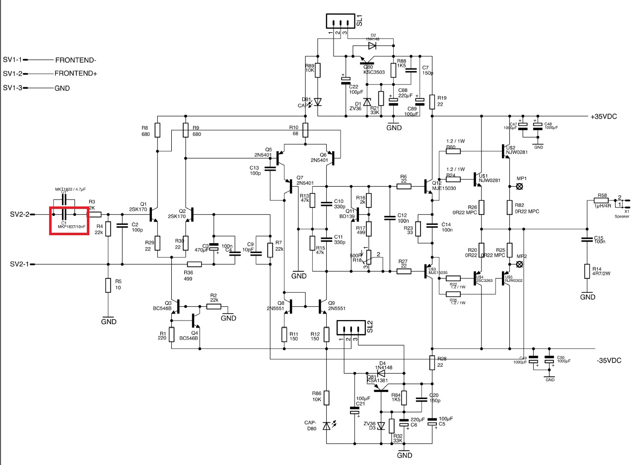

It appears he has picked the BJTs outline that have the same pin out so that the jFETs fit the PCB. And then labelled them so that you see what to use.
He has used very low value source degeneration resistors indicating that he realises that these jFETs don't work optimally with the much higher values used by BJTs.
And these 22r are big enough to allow the Builder to check that the jFETs are truly balanced currents.
expect ~30.0mVdc across the degen resistors
and ~1000mVdc across the drain loads. and ~400 to 450mVdc across the CM degen.

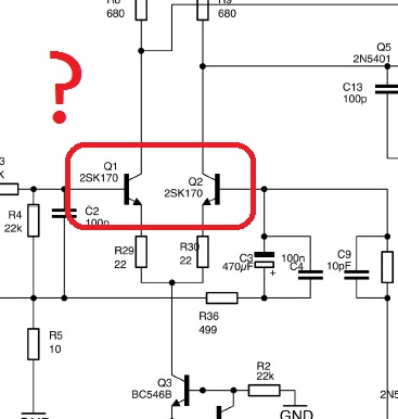

I have a problem with my built. I have on one monoamp across the fuses 3,7V instead of 1,5V how it's described in the manual and on the other only 0,5V. All the LED's are working except the Status LED in the SPK Protection Section. I measured all Resistors they are correct. I insulated all screws. Has anyone a solution of this ? Ask if you need more information
Kind Regards
Have you turned the output bias ON?
Turn the output bias right down till it goes OFF.
Then check voltages around the amplifier to prove that it is assembled correctly.
Well, I found the fault but I don't know what I can do now. I have a transistor Socket for Q1 and Q2 (Input differentials) to change Transistors fast to hear the differences in Sound. If I put a matched pair of BC550C in it the Amp doesn't work anymore (I can hear the click from the relais in the SPK protection without inserted BC550C's). Do I need other Transistors like 2N5551 ? In the User Manual there is described you can use BC550C... I'am confused now ...
BTW: without the input transistors the Voltage on the Fuse Sockets is around 0,3V and ALL LED's work ...
The Transistor Q5 gets hot after seconds as well ...
Administrator
Joined 2004
Q5 and Q6 should run at the same temperature, and not hot.
Have you decided to use BJTs instead of J-FETs? Otherwise the BC550C should work fine in that circuit. What are your supply voltages? If you can't find real 2SK170 transistors, try J202 transistors. Much lower transconductance than the 2SK170, but real parts will trump fake parts every time. For BJTs I was using 2SC1775A or 2SC2240s, but the BC550C are low noise, high gain parts that should work great.
Matching J-FETs is straight forward using information from Nelson Pass or Walter Jung. The BJTs need to be matched using a jig (J-FETs use a jig too where you match Vp and Idss) for beta. Vbe isn't important, but will match closely as a side effect of close beta matching from the same batch of transistors. Buying them on tape from the factory (cut tape option from a proper distributor) will insure that.
