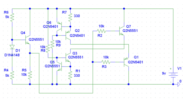

Thanks for the information! I have used 9.2 kOhm instead of the 100 kOhm to increase current to a value closer to the final working current. Not sure if this changes things?
However, I have by now decided to stick to the Hfe values I have measured with attached circuit.
(Q7 and Q1 are the DUTs and one measures voltage (Vmeas) across the 10k resistors. R1 & R7 set the Iq. Hfe= 10k x Iq / Vmeas; originally provided by M.Bittner to the German AAA forum but not sure if this is the very original source)

Hi Dirk83,
I haven't seen that circuit before. Interesting. I do now that in order to get matched beta, you need to put the two transistors in a diff pair configuration. What you have there wouldn't do that.
Why not just build the circuit others have used successfully? It is simple and very direct in the way it operates and all you need is some kind of null detector. The meter used will measure in mV and the only critical thing is an accurate zero. Any voltage measured is a degree of mismatch, and that is only marginally important. I did match my transistors using the jig, and it turned out great. My DC offsets are below 5 mV without any adjustments. That's pretty good. The distortion was also very low but I can't remember what the numbers were. I know I was very happy with the performance. The diff pair determines what distortion performance you have, so it would seem a valuable thing to set up.
The collector resistors don't have to be 10 ohm exactly. What is important is that the two resistors are very close to each other in resistance. You're making a radiometric measurement. You could probably use a centre tune meter from an old receiver (but short it when changing transistors!). For me, ordering the resistors as 0.1% made life simpler, so that is why I used them. I can also then calculate the hFE pretty accurately as the base resistors were also 0.1% tolerance parts. That represents the most expensive part of the matcher unless you buy the PCB from someone.
-Chris
-Chris
Hi Chris,
thanks for your opinion. Indeed, I was looking for a simple circuit for a while but the web is full of different circuits and just confusing.
From your posting I read that you think direct matching is more favourable!? In particular after seeing the temperature related shifts in beta I would agree (if I read your post correctly) and would have preferred this. That's why I was looking for an alternative like the one from Ian Fritz (measuring Vbe)that I have build. Saying "Vbe" I also got confused since some people seem to prefer it over the Hfe matching but I am way way too unexperienced to judge on my own.
I will for sure consider to build the circuit you have linked. Thanks again for your helpful comments.The only thing holding me back right now is the time I have spend already with measuring (~500 transistors).
Best,
Dirk
Edit: Are the PCBs available somewhere? As mentioned, I am not that experienced and I wouldn't be sure that I can correctly build your designed/posted circuit correctly. Thanks
The one shown in my post has been used by quite a few people in the German "Symasym Community" and has even been references in the German SymAsym Wiki, which is not online anymore. This are the reasons why I decided for this circuit.Why not just build the circuit others have used successfully
The circuit is no direct matching of two transistors but one measures beta individually. The two spots allow measuring NPN and PNP.I do now that in order to get matched beta, you need to put the two transistors in a diff pair configuration. What you have there wouldn't do that.
