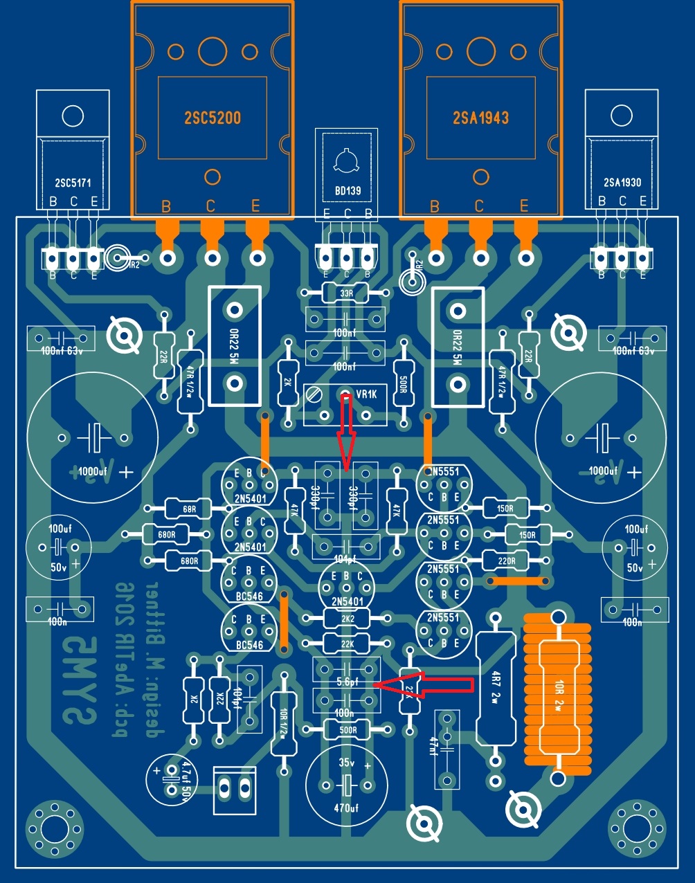

If Q8 does not turn on then it's voltage regulator function will not be in operation.
That would leave a high voltage across the Vbe multiplier.
Yes, reduce R13 to 2k2, You could even reduce R13 as low as 1k5, but any value from 1k5 to 2k2 will do the job.
There is something else going on.
A short across the Vbe multiplier?
BTW.
the ratio of R13 : R13+R35 sets the voltage ratio of the multiplier.
Vmultiplier max ~ 2k2+330 /330 *Vbe = ~7.6*Vbe this is comfortably above the 4*Vbe across the output stage to just turn on all four driver and output devices.
The minimum Vmultiplier ~ 2k2+330+1kVR / 330+1kVR = ~2.7Vbe
This is comfortably below 4*Vbe, but does leave a significant voltage across ther driver bases. This is the part that is not working. Find the circuit assembly error.

Going back to my SymAsym build, I can't make the bias adjust to work :scratch1:
It worked the first time I power the amp, set it to a low 20mv across both 0.22r just for a test run. Following the other day I cannot measure any dc voltage across the re and at the bases of the drivers, totally zero, none. Playing music with it, it will work and I can get DC voltages but without music it goes back to zero. I thought I messed up the vbe 1k trimmer because I am hearing faint clicks while repeatedly doing the process. :h_ache:
I decided to run a simulation of the amp and made new values at the bias circuit for use with a 5k trimmer (believing I busted my last 1k trimmer but never bothered to check it off board) but after placing the new values on board and adjusting the trimmer per simulation result, it still didn't work. 😕
Attached is a revised pcb lay-out and my schematic. Notice the addition of a small resistor at the ltp emitters (R36), this reduces a few CCS current because DC transistor condition in sim shows that one trannie is hot (Q6 tied to 22k-ground). The 2.2k addition seemed to lower the THD figure (in simulation).
My actual build is working nicely, sonic is very good, dead silent and no turn on/off thump... I just can't figure out why biasing stopped working or is not working. I have check the drivers, vbe bias and output trannies but found no indication of any defects....any ideas what has gone wrong and where to check for possible fault?
BTW I am using c5200/a1943 and c5171/a1930(drivers), DC offset is -12mv (no matching done).
Regards!
Albert
this 2 point should be open circuit.
