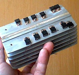

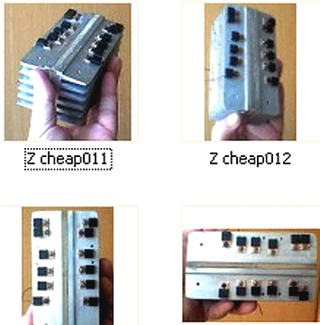

"Z" chip zoom... fast discrete chip construction.
I found those TIP41 and TIP42...all them "C", for 100 Volts, 6 ampéres and 65 watts dissipation (i do not believe)... speed is around 3 Megahertz - db roll of frequency.
Well, all those were bougth same day, same shop, and the gain variations are under 5 percent... they are almost the same..so...no need of equalization resistors...they will be installed in parallell, to be cheap...no stop resistors to avoid input capacitances, no emitter resistors, no diodes...nothing... a cheap Macro Chip, to use those units.
390 watts may the maximum.... so, they will fit one Symassym amplifier made for bass...even under 2 ohms loads (around 250 RMS... depends on supply) the transistor will hold the power as heatsink will have a direct fan over it, and whole enclosure will have one blower forcing air to go inside and one exaust fan to remove warm air from inside...all them with 7208 voltage regulators to reduce speed and wind noise.
Of course, capacitances in parallell may produce a slower result...well...to bass!!!....who cares?

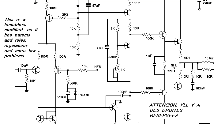

here is the image of the amplifier i dislike...the lamebless....i cannot publish the one, as is protected by rules and regulations..so, this is lamebless...having nothing related Dr Self amplifier (hehe)
Michael said will try to discover what happened!..he will study the amplifier and assemble it to check and correct...if needed.

Please, tell me what you see, or much better, what you feel watching the Blame grrrr schematic.... send me direct mail, as there are a lot of guys that love this circuit...and to avoid disturb them..go direct mailing.
enjoy it...i am sure you will apreciate it... the icecream, naturally

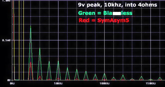

Good informs Anatech..happy to see you...this is some graphic made by Michael
Where he compared Symassym5 with the bla less amplifier.
He told a lot of words i have not courage to repeat you here.
But i am sure not so good words...he will not assemble...as he has not 12 gauge, double barreled and not condition to shot the thing.
