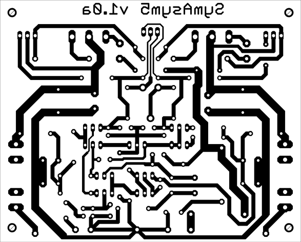

Hi Carlos ! I don't know whether Blameless has any secrete . Blamess amp can be found at this site http://www.dself.dsl.pipex.com/ampins/dipa/dipa.htm
I didn't use D1 1N4148 .
C4= 100n ceramic cap
R16 ,R17 emitter of output tst =0.47 ohms
Self 's VAS current source . I use the current source which Mikeb often use include 2 transistor ,10mA for VAS
beta of TR2 =204 and beta of TR3 also equal to 204
beta of TR10 = beta of TR11 . Digital multimeter use numbers to display result so it is easy to read .
I dont pay attention to how beta of tst is . But I'm sure that beta of these tst is equal to each another exactly . Ok! Digital multimeter is better .
TR12 =2a1038 (or 2sa1308 , I forgot ) , beta =438 . I dont want TR12 eat too much current from current mirror .
TR4 ,TR6 ,TR8 =D669 ,B649
I use two-pole compensate network include 47p cap 1k resistor 470p cap
R9=100 ohms

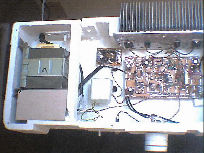

Put together one channel and was ready to fire it up, when I discovered that I had ordered the wrong transformers (35v instead of 25v), aarrg. I couldn't wait to get the correct ones, so I hooked up the circuit to a regulated -/+ 25v gainclone power supply with 100R in series with each leg. The 68R for the second differential pair started to heat up so I shut it down. When I went over everything, I discovered that I had mislabled the pin-outs of the BC556 and 2n5401 - oops. So I checked them out and reoriented them.
Viola! After adjustment of the trimmer, all the voltages check out fine. Offset of -1.6mv and residual AC of 0.2mv (meter's limit). So, I'll build the other channel while I wait for the right transformers.

Hi Carlos,
Nope, no thump.
I only matched the transistors by using a 9v battery across the transistor with base attached to collector and 22k in series. Then measured across the transistor. Seemed to work for the small devices, as I have less than 2mv DC offset at the output.
Not so good, but better than nothing, for the output transistors as the current is low with this method. Anyway I took the best complementary matches for the drivers and outputs.
Next time, I'll try a more comprehensive transistor test.
