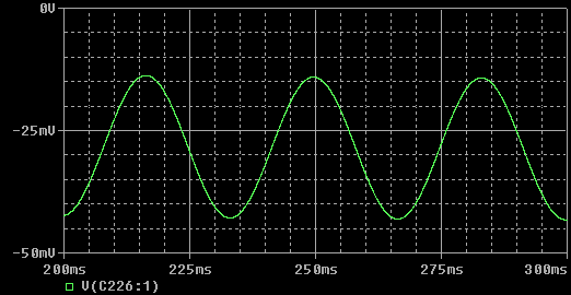

The 220uf-cap after the feedbackdivider is a normal electrolytic,
(i used 470uf,16v here) can be a low voltage type, with plus to gnd.
It gets charged with ~12mv (depending on the hfe of the input-bjts)
Mike
Thanks Mike. As I said, my experience is limited. I've only built one tube circuit that was entirely from a general schematic that I modified a bit. Along the way, I looked a a large number of similar circuits and various feedback applications. In those amps, some sort of feedback compensation caps are fairly common. But the great majority were caps across a feedback resistor, either to shunt high frequency noise or to shape the output. Your caps are in series with the feedback resistor to ground. Beyond just soldering in the right part in the right orientation, I'm trying to figure out what everything is doing there. The small cap, I get. But I'm a bit puzzled by how the larger cap interacts with the output and base, as there is no direct connection between the divider and ground. Do you have a handy reference I could check that covers the principles involved in this particular application?

Hi Sheldon,
The cap in paralell (22pf) to the feedbackresistor is a "phaseshifter",
partially reverting the phaseshift introduced by the circuit from
input to output. It's mainpurpose is avoiding overshooting.
The other cap in series with the 499ohm, is a DC-blocking cap.
It has 2 functions, the first is to reduce gain down to 1:1 for DC,
enabling the whole openloopgain to feedback for DC.
The second is, by increasing the 499ohms to infinite for DC, the
inputresistance of the -input of diffamp becomes 22k at DC, the
same as on +input. This results in identical inputoffsets on both
sides of the inputpair, again greatly reducing DC-offset at ouput.
Or did you mean the 330pf in vas to gnd ?

Thanks Mike,
I'll chew on that. The DC block seems the obvious answer. In fact, I probably wouldn't have given it much thought if it were a non polarized cap. What has me confused is using a polarized cap, from which I inferred that the total voltage across the cap is always oriented one direction. But as the signal from the output swings =/- up to 36V, I didn't see how that could be the case. I was trying to imagine operation that doesn't put a reverse polarity across that cap. Is it just that the voltage drop the cap sees is low enough not to matter?
Sheldon
The point is, you need a very low frequency to get this cap charged
in reverse polarity. Typically it is charged with ~12mv and creates
an offset with this voltage to gnd for the 499ohm-resistor.
But the inputcap avoids entering that low frequencies into the amp.
I can show curves for that later. A nonpolarized cap is necessary if
it's not sure with which polarity this cap get's charged.
And i have heard that an electrolytic can be charged with reverse
polarity with low voltages.
Mike
Ok, I think I get it. If I can restate what you said: There is a slight offset that the feedback input is riding on. The feedback signal averages to zero so, as long as the frequency is high enough (controlled by the input cap), there will remain a slight net charge across the cap at any given point in time.
Final check then, and my apologies if I seem thick headed. I interpret your initial answer such that the cap should be oriented with the + lead to ground. But I note that on the first page of the thread, Carlos showed some of what I assume are spice outputs. In the voltage output, it looks like +27mv at the base of the transistor/connection to the cap. If I understand your explanation correctly (not a given yet), that would seem to indicate that the cap should be placed with the - lead to ground. On the other hand, the only current path I see is through the base to the negative rail, which would seem to imply a slight negative charge on the base, and would be consistant with your advise on the cap. Which one have I got wrong, or is the - sign there and just too hard to read?
And many thanks for your gracious and very prompt answers.
Sheldon
Hi Sheldon,
You got it correct !
the minus is hard to see, it's -26.96mv, i don't know from which amp
i remember the -12mv... The basecurrent flows through the 22k to the
ouput, this creates the -27mv. So, the -pin must go to gnd.
I attached a shot out of sims, 30hz, full power, you see that the
charge of the cap keeps its polarity. It's a 470uf, so it seems a good
choice to use the bigger 470uf instead of the 220uf...
At 10hz it looses the polarity, but who does play a 10hz at these
powerlevels ?
Mike, not yet sleeping...
