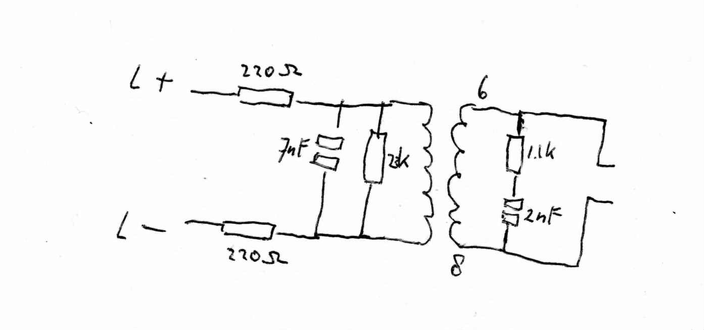

@ Bill,
I read through the connected posts again and decided to try a 2.2k Resistor across the primaries. The DAC-chip sees about 1.5k now and the trannie about 300 Ohm. I guess that's better and yes it sounds more convincing already, but have to listen more.
See:

Because the topend sounded not good I did some experimenting with listening and measuring with audiotester.
It looks like there is a 6 dB peak at about 33 kHz after which it goes down rapidly. With the RC the peak gets lower but a small peak at 20 kHz.
With the primary C there is a small influence too.
Then measuring the phase it looks horrible with the C's in!
Out the C's and the phase is flat between 200 and 20KHz.
Listening I did with Hallelujah by Bon Jovi. With the C's the voice gets really cracky, raspy, without the C's it sounds natural.
Next step try the listen to the difference of the shunt-R on the primary.
Maybe with it it sounds a little bit sat on.
So far..
Thank you all; especially Bill

For me the sound gets much better with a low sourceimpedance to the trafo.
I lowered the seriesresistance from 2 x 220 to 2X 47 ohm.
Everything improved, more natural and strong bass, cleaner and brilliant highs and more depth. A parallel resistor at the primary lowers the sourceimpedance too but for me it gave a loss of dynamics and sounded a bit strange.
Maybe I'll lower the seriesresistance to zero. Hope the dac doesn't mind.
It looks like the impedance is more important for the trafo to be right then for the DAC-chip.
The datasheet and measurements confirm a lower phasedifferense in the bass with lower sourceresistance. Distortionmeasurement gave at least 6 dB less distortion and 20 degree less phasechange.
